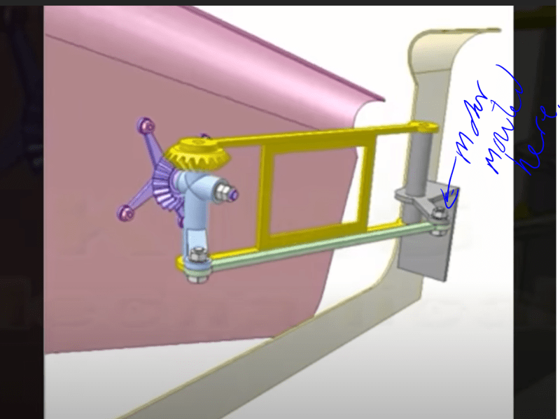

The scissor car door (06:00 mark) is the exact movement I'm looking to create!! The door panel is around 800mm wide and will weigh around 125lb. Looks like this is a much smoother and simpler way to accomplish what i'm trying to do. If i mounted the motor above the pivot point marked on the image below would that be the best place or would there be a better place?
Thank you for finding this.

Hello,
Glad to help. Two thoughts:
1. The closer to the CG you can mount the pivot (the purple part mounted on the door) , the less lifting load (torque, moment etc.) you will need to account for.
2. I think the better location for the motor is on the yellow arm rather than the green link arm.
3. If a scissor door is what you want, take a look at some of the automotive solutions that have been used over the years for additional ideas.

The correct drive point is the pivot of the yellow link, at the car frame end.
