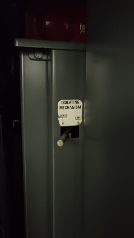

Came across several GEC VMX 13.8 breakers in Saudi Arabia. Looking for the O&M manuals.
At least 6 breakers have been pulled out as most them do not close after charging.
If someone can help me out with this.
Also is it possible to send them back to the UK for remanufacturing.

One thing to check when closing them is that the isolating mechanism (to the left and slightly back when looking face on) is on 'locked' and not 'free'. Otherwise it makes a clang, the springs discharge, but the isolator does not close. If this happens you have to rack the breaker back out and it is possible to force the mechanism over with judicious use of a large screwdriver. I've not done it, but i've seen it done by our HV contractor.

Thanks. The isolating pin is stuck in most of our GEC breakers that have been removed. They were not stored in a clean environment. I Will be lubricating them.

"Some of the VMX breakers have the plastic shroud/body damaged or removed entirely.
Are they safe to operate as the isolator pins are exposed at the bottom?"
I wouldn't operate them like that, and looking at the flexible shields at the bottom of the insulator, they appear to be suffering from a bit of heat damage. The one VMX that we removed last week had worse damage than that, but also had corrosion on the contact petals and arcing down the side of the insulator. Our HV contractor says that compared to the old BVPs, the VMX is shit. There was no visible damage on any of the eight BVRP-17's that were removed.
