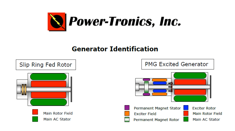

This website has tons of good information:
If your unit is brushless and excitation current is high, it sounds as if you have a diode failing shorted on the rectifier ring.
A bit more (ok a lot more) info would be helpful to give you a good recommendation. My go to source for brush type generator AVR's is Power-Tronincs, they have a large line of AVR systems and excellent technical support.
The field power requirements between brush type and brushless generators can be quite large.
Here is a simple set of descriptions of many generator types,

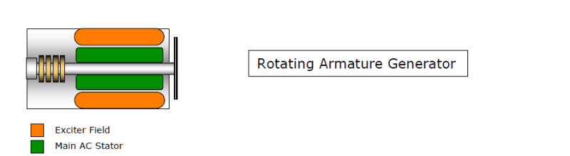

There are three types of brushed generators.
1. Some have a stationary field. The power is taken off of the rotor with slip rings. This will have a special AVR, but I haven't seen one of these for years and it was very old then.

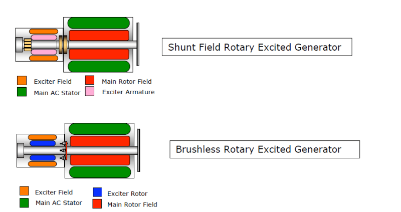

2. Some have a static exciter/AVR and slip rings to take the DC to the main field. These use a special static exciter and may have an internal AVR. I have only seen one of these, and the problem was with the governor setting, not the voltage control.
3. The most common type of excitation used a small DC exciter that was controlled by a generic AVR. The DC was taken from the generator by brushes and passed to the main field by slip rings. These are the sets that were often converted to brushless.

That's a great link, Mike. Worth an lps.
From Mike's link, what I tried to describe, illustrated clearly.
