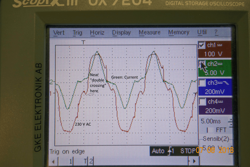

OK, this is what an old (around 15 yrs) does to a perfectly Clean mains voltage when there is some inductivity (around 50 mH) in the path.
So, the generator isn't necessarily the culprit. High source impedance (expected in a small generator) plus distorted load current are to blame.
Gunnar Englund

Thanks. Primitive zero cross detection. Absolutely. I have been designing trigger Circuits for SCR (DC drives) and we had to use the mains voltage with commutation notches in it. Needed a two-pole filter for that. Don't think they have that in Micros.

Thanks for doing this. Out of curiosity, was the microwave clock keeping the correct time with this waveform?
There is no clock. Just a set of LED:s that step down until finished. I didn't check the pace of them. Should've done that. But it wasn't that easy to arrange the measurement. So I don't think that I will do that again. Someone else, perhaps? With a more modern Micro...
