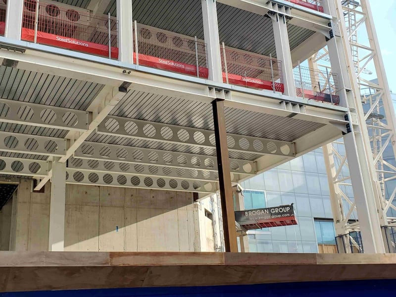

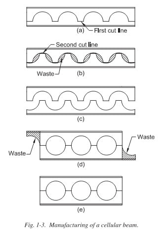

- #1
MIStructE_IRE
- Sep 23, 2018
- 816
Hi there,
I was active on this forum for years.. One of my last threads on this forum was about getting out of engineering altogether..
I have worked in the industry for some time. I’ve designed some crazy shit other engineers shy’d away from and have worked in many corners of the work. I have been very proud of the stuff I’ve designed and for a long time really loved what I did. I also felt I contributed on here quite a bit.
Last summer, I had a work related burnout/breakdown. It was the lowest point of my life. It really was an experience, somewhere I never would have seen myself going! But thats what lift is all about!
I‘m sure there are many new faces here, but I want the guys I do, and did, know, to know that I’m back baby! I’m back in the industry and back to my old self.
I hope you all cope with the responsibilities of engineering better than I did!
Thank you all
I was active on this forum for years.. One of my last threads on this forum was about getting out of engineering altogether..
I have worked in the industry for some time. I’ve designed some crazy shit other engineers shy’d away from and have worked in many corners of the work. I have been very proud of the stuff I’ve designed and for a long time really loved what I did. I also felt I contributed on here quite a bit.
Last summer, I had a work related burnout/breakdown. It was the lowest point of my life. It really was an experience, somewhere I never would have seen myself going! But thats what lift is all about!
I‘m sure there are many new faces here, but I want the guys I do, and did, know, to know that I’m back baby! I’m back in the industry and back to my old self.
I hope you all cope with the responsibilities of engineering better than I did!
Thank you all
