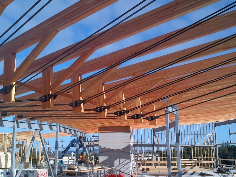

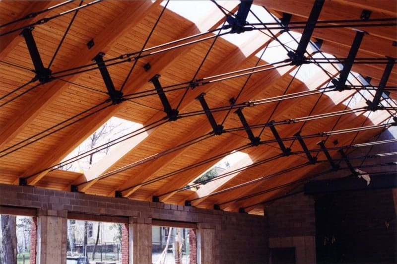

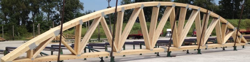

all the back and forth of plated-wood Trusses discussions, came after the church renovation/expansion. My question
1- did you done some repairing works for large span wood Truss ? like using FRP laminates (with epoxy).
2- did you use strands/cables (with some pretension) ? any cable configuration is the most effective
3- Are those repairing techniques effective timewise ?
i tried to add some related pictures for clarity
Note: Reasons of asking is to learn about wooden structures construction/practice
and thanks for your Reponses

adn26 - Ron is a metal plate connected wood truss designer. He has nothing to do with those behemoths you posted (except the one in the middle that looks to be a pack of trusses on a stand waiting to be erected). They're really fascinating, but not exactly relevant to Ron's expertise (at least as I understand it).

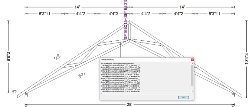

You asked for pictures to better explain what I meant. So today I input a 28'scissor truss and played with it a bit.
The first example is 4/12 over 2/12. The difference between the two pitches is 8.9°.
Total horizontal deflection was .51" (For both live and dead loads)
Second example is 6/12 over 4/12. The difference between the two pitches is 8.2°.
Total horizontal deflection was .98" (For both live and dead loads)
Third example is 8/12 over 6/12. The difference between the two pitches is 7.1°.
Don't know if you can read the text, but the total horizontal deflection is 1.61". And you can see the error message that shows it exceeds the TPI limit of 1.25".
So as you can see, as the pitches increase, the horizontal deflection rapidly increases.
And while it sound on the surface like the 2/12 pitch difference between the TC and BC is maintained, the angle between the 2 also rapidly decreases.
Since you guys deal with math all the time it might seem easy to you. But this is a misconception I run across all the time.
