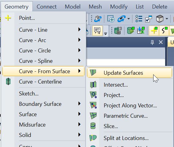

When I extend an edge to a solid or surface, FEMAP automatically imprints a new line on the solid/surface (surface 1 in the below) . This is ok, until I extend an adjacent edge to another surface (surface 2 in the below) . The original remains, which can lead to sliver type elements when meshed. I can fix it by removing the line, but seems a bit of a faff, especially when there are a lot of edges to extend. Is there a way of switching off the imprint function
I can use mid-surface intersect when the geometry is ready for imprinting edges etc.
