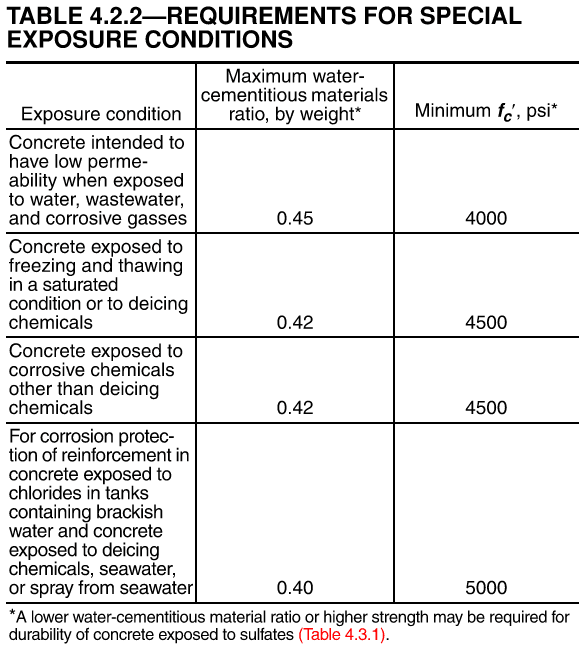

What concrete do you use for these farms? C20 or C30 or is it some special mix.
Here's a table from ACI 350-06, "Code Requirements for Environmental Engineering Concrete Structures". I've generally used 4,500 psi as a minimum.

I'd have used w/c of 0.4 for all those conditions.
