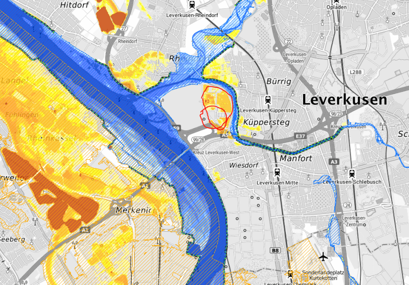

Considering the recent flooding in germany, perhaps water contamination of some of the chemicals led to the explosion, similar to the Bhopal India event. Not a good time to be a fireman.
don't know if the specific area the plant is in was flooded, here's a map of the area with flood plains (blue) and risk areas for flodding (yellow) highlighted - the area around the chempark is highlighted, I'm not sure sure where exactly the incident happened but I think it's the near the smaller circle:
map from here:
