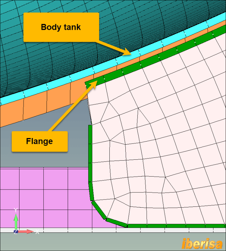

I have loaded your BDF file in FEMAP and I see a critical modeling issue if you plan to solve your model using the Linear Static (SOL101) nastran solver using surface-to-surface contact no penetration: the body tank and the flange bed faces are not touching, you have an important GAP between them. In linear static contact problems all touching faces must be mounted in physical contact, is not correct to let the solver to do the job to move the model, this is large displacements effect and a nonlinear analysis is required.

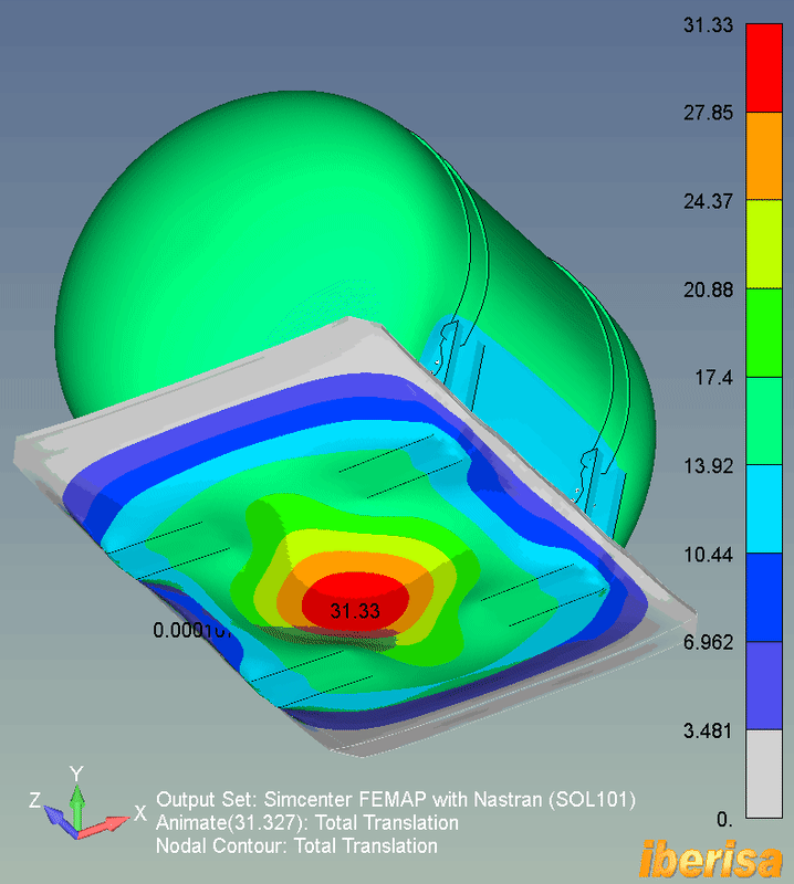

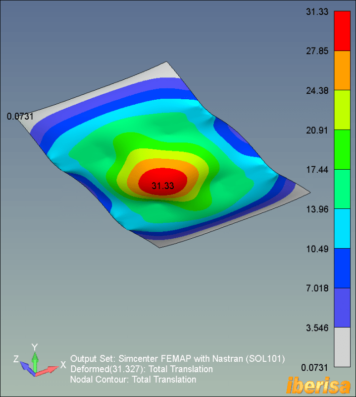

I have solved the model for linear static (SOL101) using the LOAD CASE#5 GRAVITY 12G in vertical direction and I I have set all connectors to have GLUE contact, then not matter the shell faces are not in contact the GLUE connector transmit loadings. The animation of resultant displacemente deformed shape shows big values above 30 mm: for that acceleration the behaviour is totally nonlinear, then a linear static analysis are simply colors (deformed shape exagerated, of course, is only for trending).

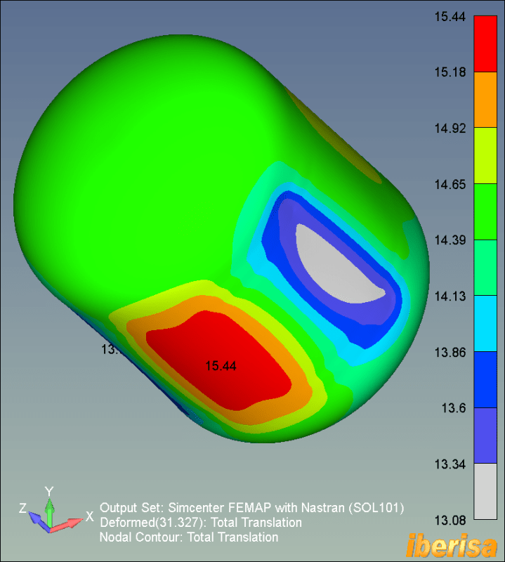

Investigating I see the BASEPLATE is the "guilty", the tank resultant displacement is "only" 15 mm, a big value for a tank thickness = 3 mm (clearly the problem is nonlinear).

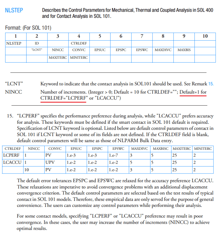

I have run the analysis with the NLSTEP card as you told me. However, I did not find the NINCC parameter directly in HyperMesh, then I defined the NLSTEP entry as follows :
NLSTEP 7 LCPERF
Which according to the QRG sets as default NINCC = 1 for SOL 101 (cf. image below).

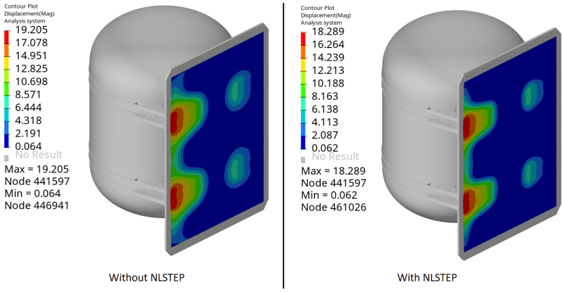

I can constate that the calculation time is noticeably reduced. Nevertheless, I find different results (cf. figure below). Is it normal ?.
I leave both .bdf files attached so you can compare if you desire to. I compared both files using Notepad ++ Compare Plugin to verify that NLSTEP entry is the ONLY difference.
