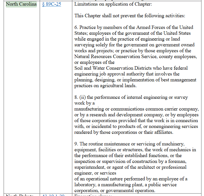

Since these rules vary state to state and we're all in different states (or countries in some cases), I thought it would be useful to post source documents from North Carolina, where I am licensed and occasionally practice.

Although the court doesn't seem to mind (legally) if he's licensed or not, I think it's important to compare Rule 702 with the definition of the practice of engineering for the state of North Carolina:
NC Legislature said:
Any service or creative work, the adequate performance of which requires engineering education, training, and experience, in the application of special knowledge of the mathematical, physical, and engineering sciences to such services or creative work as consultation, investigation, evaluation, planning, and design of engineering works and systems, planning the use of land and water, engineering surveys, and the observation of construction for the purposes of assuring compliance with drawings and specifications, including the consultation, investigation, evaluation, planning, and design for either private or public use, in connection with any utilities, structures, buildings, machines, equipment, processes, work systems, projects, and industrial or consumer products or equipment of a mechanical, electrical, hydraulic, pneumatic or thermal nature, insofar as they involve safeguarding life, health or property, and including such other professional services as may be necessary to the planning, progress and completion of any engineering services.
A person shall be construed to practice or offer to practice engineering, within the meaning and intent of this Chapter, who practices any branch of the profession of engineering; or who, by verbal claim, sign, advertisement, letterhead, card, or in any other way represents the person to be a professional engineer, or through the use of some other title implies that the person is a professional engineer or that the person is licensed under this Chapter; or who holds the person out as able to perform, or who does perform any engineering service or work not exempted by this Chapter, or any other service designated by the practitioner which is recognized as engineering.
Emphasis mine
So by my reading, even though the rules of evidence don't mandate a PE explicitly, it's implied by the fact that doing it puts you squarely within the way the legislation defines the practice of engineering, for which a PE is required. But wait! There's more. As CWB1 rightly mentioned, there are exceptions to this rule. And in some states, those exemptions may very well cover engineering witnesses. But again, not all states are the same. North Carolina is very specific in what is exempted from the definition above, and they are listed in S 89C-25. Limitations on application of Chapter and summarized by NSPE in this state by state guide:
You'll notice that expert testimony in court is NOT listed as an exemption.

I'm thinking of two problems with the idea that being an expert witness on an engineering matter is "offering your services to the public" and would require licensure:
[ul]
[li]What happens when the testimony is about something that was designed under an industrial exemption? Many of the most qualified potential experts to speak about it wouldn't have their licenses because they also work under the industrial exemption.[/li]
[li]Where is the potential liability? You aren't doing anything that could end up in someone getting hurt or causing property damage.[/li]
