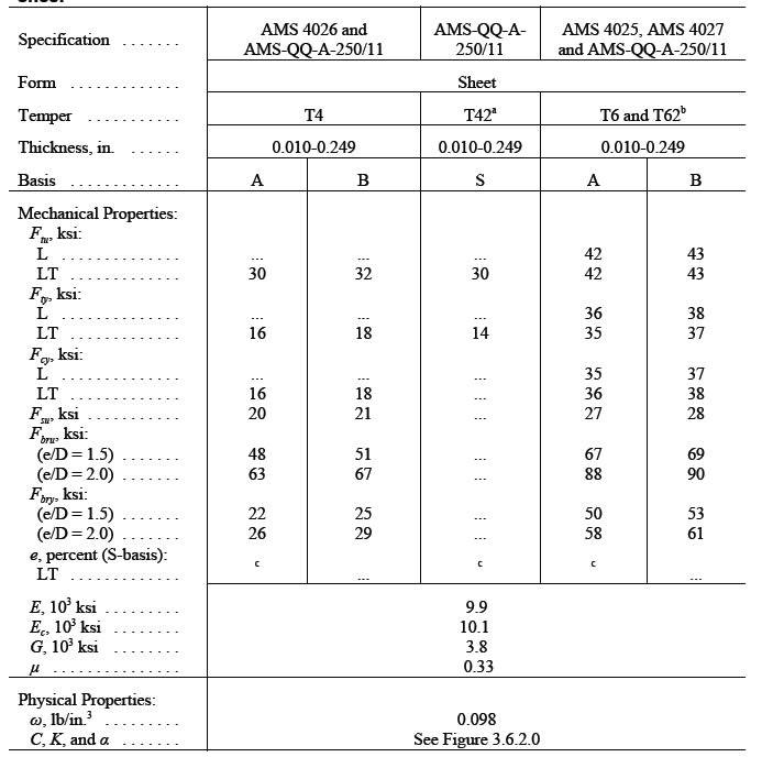

MMPDS is an official source for aircraft material properties. If you do not have this, it was formerly MIL-HDBK-5, which should be publicly available. Have a look at the properties for the various alloys and heat treats. Here is an example demonstrating no change in E for the 3 different heat treats. You will find this to be a recurring theme and E will only vary with a change of alloy. However, the change is usually slight (sometimes more significant for steels because there are quite a few variations to the composition).
Brian
