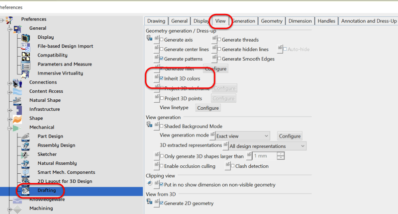

Graphic properties are not applied from 3D to 2D.

In an assembly, I changed some catparts properties as below; Right click-Properties-Graphic properties-Line type-Dotted Lines(or anything). Also Right click-Properties-Graphic properties-Thickness from 1 to 2 mm. In 3D assemby everything looks fine.
I want all new properties I applied in 3D to be visualized in Drafting also. But this is not the case. The edges are not represented as in 3D with dotted lines. How can I do that automatically? Please see the attachment
Thank you
 https://files.engineering.com/getfile.aspx?folder=4986c376-0d19-43a3-a8ea-7ba0e578a1d6&file=properties_2D_.JPG
try this:
