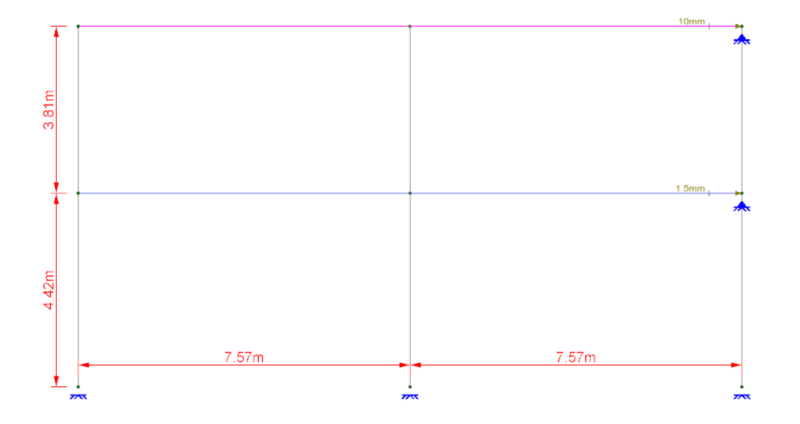

The usual situation is a shearwall building with concrete floor diaphragm and internal concrete beams/columns to support the floor
The relative stiffess of wall vs slender column/beam means that the drift of the building is completely governed by the walls
This will probably be on the order of 2-20mm for typical low rise buildings
So you just make a model of your concrete frame and apply that drift as a nodal displacement
I would assume a fixed base in this assessment (or at least a realistic rotational fixity) as this will increase the demands for a given drift

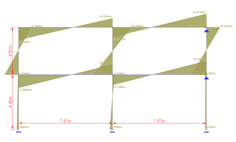

Here's a snip from a job where I did exactly that
@green - do you consider a displacement increased by the q (or R) factor? I get high demand on columns that way, although I use the same method as you. Also, if you place supports, won’t they have lateral reaction from displacements? Is this something that should be considered in design in some
way?
