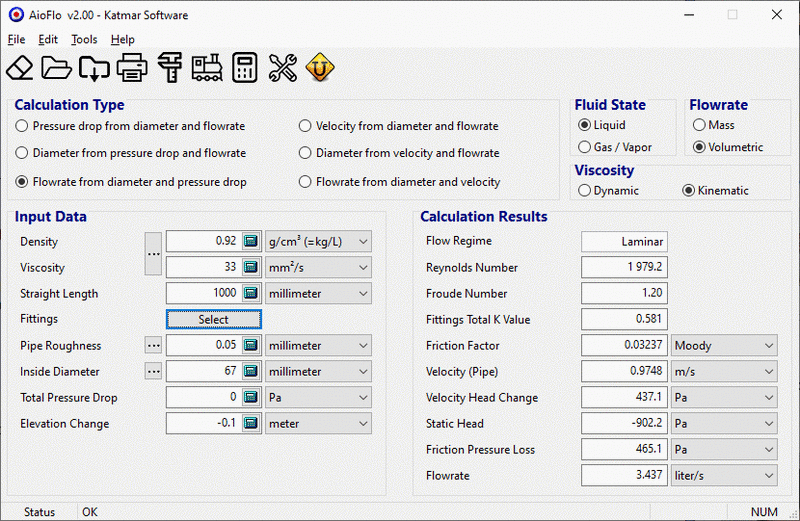

The application is for draining a very small bund - less than 200mm high. The vessels in the bund will overflow it if the oil is not drained away effectively. The oil is has a kinematic viscosity of 33 mm^2/s, density of 0.92g/cm^3, so it flows fairly well.
I tried using the Hagen-Poiseuille Equation, but the results were unreasonably high. A 1000mm long 3" (67mm ID) pipe with 100mm fall could flow almost 15L/s. Based on THIS METHOD, I'm expecting around 5L/s which intuitively 'feels' about right.
The open channel flow calculator provides a more reasonable value of 8.6 L/s (based on a full pipe), but I can't see how to solve it manually. The variables end up in a loop [Re < W < Q < Lambda < Re]. WHen I search open channel flow, I keep getting the Manning equation which doesnt' consider viscosity.

With the additional information you have provided I have "run the numbers" using Darcy-Weisbach and my results are significantly lower than yours. Most of the information you can see in the included graphic but what is not shown is that you need to include the entrance losses of getting the oil into the pipe and also the energy consumed in accelerating the oil from standstill to about 1 m/s.
Note that the pressure drop is shown as zero because you have atmospheric pressure at both ends, but the driving force comes from the -0.1 m elevation change.
As an illustration of the effect of viscosity, if the viscosity is changed to 1 cP (water-like) the flow increases to 3.64 liter/second. A 30 fold change in viscosity changes the flow rate by 6%.
Following LittleInch's advice - a 100 mm ID would give a flow of 7.8 l/s and a 150 mm ID would give 18.5 l/s.
