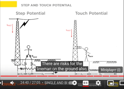

Hello all, I'm a new Engineer for a utility power, and I'm trying to figure out what other alternatives is out there for ground mats or equi-potential mats, these suggestions come from the linemen when they find difficult to install these mats on transmission switching poles generally, one suggestion the made was to put ground butt plates in a perimeter as if there was a ground mat, if that makes sense.

The operator MUST be held at the same potential as the handle that he is operating.
That is the purpose of an equi-potential mat.
The equi-potential mat must be large enough that the operator is not able to operate the switch with either foot off of the mat.
Are there space limitations?
A possible solution may be a permanently installed custom sized mat that fills all of the available space, but without galvanic contact with any grounded object save the ground that it rests on.

Let me re-state my question, how would you properly ground a transmission switching pole in granite or basalt when you can't even drive a ground rod ? the normal procedure is to install a ground mat...
You completely misunderstand the principle of an equi-potential mat.
AN EQUI-POTENTIAL MAT IS NOT A GROUNDING DEVICE.
A PROPERLY USED EQUI-POTENTIAL MAT DOES NOT GROUND AND SHOULD NOT GROUND.
IN THE EVENT OF A SWITCH FAULT DURING SWITCHING, AN INADVERTENTLY GROUNDED EQUI-POTENTIAL MAT MAY LEAD TO INJURY OR DEATH OF THE OPERATOR.
THE ONLY CONNECTION OF AN EQUI-POTENTIAL MAT IS TO THE HANDLE OF THE SWITCH BEING PROTECTED.

Granite and basalt are both poor conductors. Setting a equi-potential mats on an insulating surface when connected only to the handle the lineman will be touching should reduce the step potential between the mat/handle and the protected lineman as Long As the Lineman only touches the handle while standing on the mat. If there is a fault and the lineman steps off of the mat, [nosmiley]
I have attached the instructions for the Hubble - Chance Equi-mat. The instructions clearly state the points waross makes.
See also training material
Grounding Video – Chance® (Temporary Protective Grounding)
Understanding an Equipotential Protective Grounding Zone

How does the additional connection of the mat to the structure grounding mat significantly increase voltage between the operator's feet and the handle? There would now be a parallel path for fault current from the handle to ground. One down the pole ground to earth and one down the handle-mat connection to earth. If half of a 10kA ground fault followed the handle-mat connection with 10 ft of 2/0 copper (resistance = 0.000811 x 10), the voltage would only be 4 volts.
The extra connection provides safety in the event of a bad connection in the handle-mat path.
In the event that the fault current path is down the switch actuator mechanism, all of the fault current may pass through the mat if the mat has a connection to ground.
The switch handle will be connected to the pole grounding wire (or structure if it is steel), so the current will flow through the pole grounding wire to the pole grounding electrode. If the switch handle is not connected to the pole grounding wire, then the only path to ground is through the connection to the ground mat which is sitting on the ground but not bonded to the grounding electrode. That would be a very dangerous condition.
The fairly high resistance of the mat to ground will limit the current.
Yes, the switch handle and the mat will both be at a high potential, but both will be at the same potential.
Just in case the switch handle was connected to the pole grounding wire years ago and the pole grounding wire is no longer dependable.
Industry standard:
Connect the mat to the switch handle.
Make no other connections to the mat.

Can you cite an industry standard? I've been specifying two connections to substation switching platforms for a long time. Even if all the fault current flowed through the mat, the voltage drop in the handle-mat wire would only be a few volts. I wouldn't want to be standing on a ground mat holding on to an energized switch handle. Without a solid ground, the mat would be like a downed conductor.
Note, the application in a substation, and outside the substation may be different. That is, the substation should have a ground grid, where outside the substation you do not. The step and touch potential should be small, because of the ground grid, below the substation rock.
Outside the substation, no clue what you may have.
Would you care to re-cslculate with the addition of combinations of contact resistance included in the calculations.
After years of service, it may be dangerous to assume that none of the connections has developed increased resistance due to corrosion or damage.
Over time, connections between similar metals are particularly susceptible to increased contact resistance.
