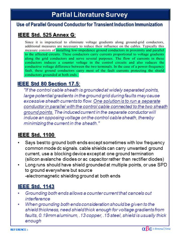

Hi Bacon4life,
Even though there are articles and independent researcher effort, I believe there is no explicit standard or official model to characterize the EMI for prediction on induced transient overvoltage in control and LV power cables.
Although many utilities use parallel-ground conductor in the trench, not all of them using this practice. For instance, It was suggested to a large host utility to include this mitigation strategy on an ongoing 230 kV, 80 kA switchyard project
Below is a partial literature survey on this subject. I hope this help.
