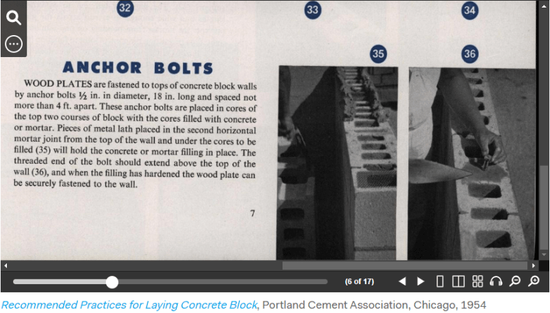

There used to be some kind of requirement for adhesion testing between the block and the grout. I'll see if I can find something on the subject. I know I read it at some point. Probably something from Amrhein.
This looks like it:
The History and Significance of Coring Masonry Walls, Chrysler, Siggard, 12th Canadian Masonry Symposium, Vancouver, British Columbia, June 2, 2013
