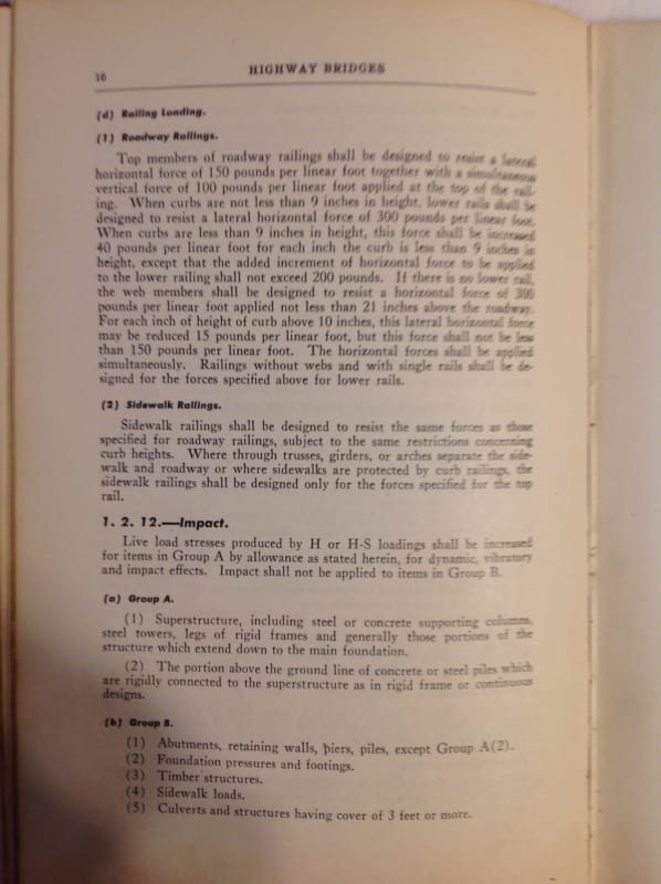

Hello,
Would someone have an excerpt of the guardrail loading specified in the AASHTO 1957 specs or older version? I have looked everywhere and cannot find anything. Any help would be appreciated.
I don't the 57 AASHTO but I have the 57 AASHO [lol]. The 53 spec is the same as 57.
Bridgebuster, you are a lifesaver. Thanks!
you're very welcome Mafradu. I have all of the AASHTO specs from '53 on. I had the ones from the 40's but they grew legs. If you need any excerpts let me know.
