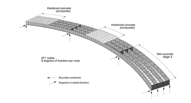

if you have spliced steel box girder (composite type with top concrete deck) with internal tendons (harped shape), when will be the time to pull the internal tendons. not that the bridge has 3 segment of 16-18-16 curved in shape to developed circular arc ?

Friend(1):
so, if the work crow did pull the tendons before the topping of concrete deck (i.e. just with open top steel box shape and the segments attached via HT Bolts) is that critical ?
Friend(2)
Yes, pulling the internal tendons before the concrete deck is in place can be critical. The concrete deck is essential for distributing the forces and providing additional stiffness and strength to the overall structure.

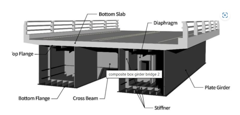

Friend(1):
are the bolts capable at top flange (of open top box girder) for the spliced girder to withstand the pulling tensile force from bottom tendons ?
Friend(2)
-The bolts at the top flange of an open-top steel box girder are generally designed to handle significant loads, including the tension forces from the internal tendons. However, the specific capacity of these bolts depends on several factors, such as:
-Bolt Size and Grade: Larger and higher-grade bolts can handle greater loads.
-Bolt Spacing and Pattern: Proper spacing and pattern ensure even distribution of forces.
-Material Properties: The strength and ductility of the materials used for both the bolts and the flange.
-Load Conditions: The magnitude and direction of the applied loads, including tension from the tendons and any additional loads from the concrete deck or traffic.
