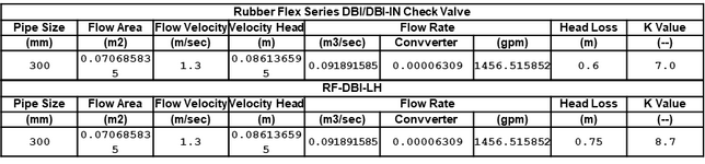

I received a response from Cla-Val with the data sheet for the duckbill check valves, showing some charts on head loss versus flow rate. After conducting my analysis, I calculated a head loss coefficient (K value) of 7.0 for the slip-in type and 8.7 for the low head loss type. The results seem off to me. I wonder if anyone here could help spot any errors in my calculations. Alternatively (let me ask again), does anyone here know what the K value should be for a slip-in duckbill valve and a low head loss duckbill valve? Thanks.

Your calculated result of the k value is in the range of what one would expect.
Don't know why you are putting such a thorough review for a check valve headloss as the headloss through a check valve is a minor headloss and can be ignored for the most part.
I also don't understand why you are even using the duckbill as it seems to be misapplied here. Duckbill check valves are typically used in low head applications like tidal gates. Duckbill check valves may not have the same reliability as a swing check valve in higher pressure applications and may not close as quickly either.
  • Like
Reactions: eea
This project of mine involves augmenting the existing sewage pump station (SPS) with a second sewage rising main. Namely, the SPS already has a rising main and my client wants to add a second one as standby. As the standby rising main could sit idle for a long time (say years), septicity is an issue if sewage backflows into it. I therefore want to place a Slip-In In-Line Duckbill Check Valve at the discharge end to prevent backflow, but I can't find the head loss coefficient (K value) anywhere.
