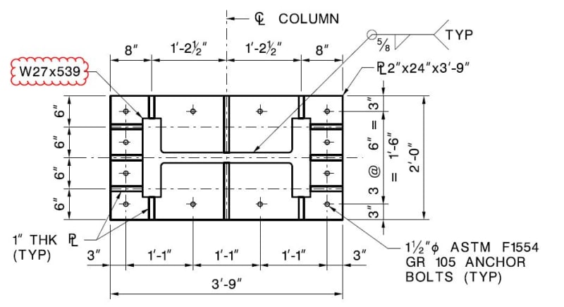

I'm working on a project where the contract plans have temporary steel jacking/erection towers that are supported on new concrete footings around existing concrete columns. The contract shows the steel base plates resting directly on the new concrete.
The contractor is proposing to using leveling nuts and a grout bed underneath the base plates.
Normally, I probably wouldn't give this a second thought, but the columns are supporting significant vertical loads (LL ~ 340 kips, DL ~ 170 kips) and will probably be in place for 3-4 months.
Is there any history or reason for concern with a heavily loaded column crushing the unconfined grout bed and overloading the leveling nuts? Other thoughts?

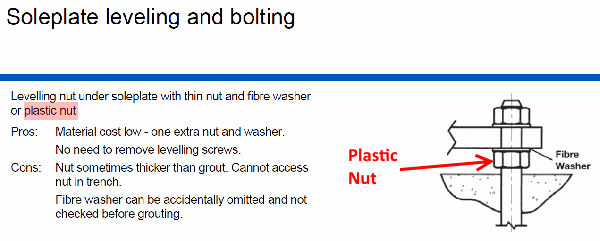

For our most heavily loaded structures and equipment (electric generating stations), grout is sized and specified to carry 100% of the load. To ensure the bolts/ leveling nuts do not carry load, plastic leveling nuts (weak, compared to steel) are used.
A compressible fiber washer of appropriate thickness and steel leveling nut will accomplish the same thing.

With this baseplate being rather large, grouting will not be a trivial thing. I would look at putting some holes in the plate to let air escape and make sure the crew doing the work has experience grouting large plates like this. The 5 Star manual probably has more info/recommendations for large baseplates that I’m not thinking of.
With the OP's large base plate of dimension of 3'4" I would use SCC as a grout material. With a grout thickness of 3" a SCC mix (with 3/8" aggregate) will result in reduced shrinkage compared to pre-bagged sanded-grouts, and better flowability (thanks to viscosity modifiers and water-reducing admixtures in SCC) .

Just following up on this...
The detail that the contractor sent over in their field change proposal showed a generic base plate cross-section (4 anchor bolts).
When I remembered that the actual base detail plate for the contract had 12 anchor bolts, I stopped worrying about it.

Plastic leveling nuts sound to me like a positively genius idea to allow convenient leveling but not be able to interfere with proper and effective anchor tightening for structurally grouted baseplates.
