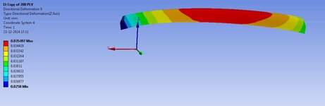

reference image used in the static structural analysis. I have carried out analysis in ANSYS for calculating the gear tooth deformation for various pitch line velocities. gear tooth is expanded/ deformed as shown below. Why the gear tooth is not having the same deformation across the face width due to centrifugal force (because of high rotational speeds)?
could any body tell why the deformation is more at center and compared to end of the teeth.
along the gear tooth face width face width the deformation is maximum the outside, no deformation at around 1/3 from inside and again deformation

I guess that whatever boundary conditions you've applied dictate the result that you've gotten.
Regarding Boundary conditions:
Only two boundary conditions.
I have given cylindrical support at the journal bearing bearing centers. (tangential is free, axial&radial - fixed).
Rotational speed (RPM) is given.
load is not considered (no-load)

The first image is shown for understanding only (representation of double helical gear).
For my project work, I have considered material as structural steel. I have not considered heat treatment. load is not considered.
The objective of the work is to calculate the gear teeth deformation because of high rotational speeds. dia of gear is 300mm and one side face width is 200mm
Are boundary conditions need to be changed??
