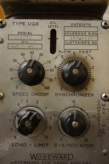

Historically, droop was an easy way to set the power output.
It had the advantages of:
Avoiding frequency runaways if a large part of the load was suddenly lost.
Helping the swing set to limit frequency excursions during large load changes.
Allowing the grid to continue in operation with a slight and usually unnoticeable frequency error in the event that the swing set went offline.

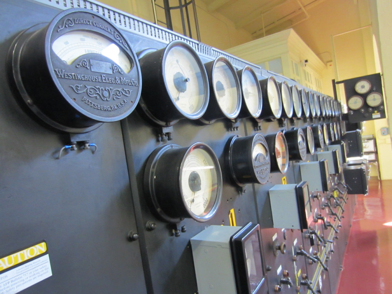

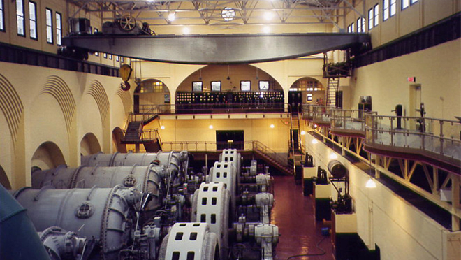

I did once visit a power plant that used a manual setting of the water flow, following telephone orders from the central load dispatch center.
This hydro plant was completely manually controlled.
Sorry. From a picture I found today, I see that even in 1911 droop control was used.
It typically ran at either 10% output or 90% output.
When I arrived, one set was running at 10%.
While I was there a call came through to go to 90%.
The operator turned a control and a hydraulic ram slowly extended to increase the water flow.
He was watching the PF meter.
As the output increased, the PF dropped.
He would stop extending the ram and manually increase the excitation to bring the PF up.
This was repeated three or four times before he got the output up to 90%.
At the time I thought that the control was completely manual but I was wrong.
I have since found a photo of part of the control panel and realize that the operator was not controlling the ram directly, but was raising the set-point of the droop control and the droop covernor was controlling the water flow in response to the changing set point.
Powerhouse at Stave Falls
Powerhouse at Stave Falls closed due to COVID-19
To ensure the safety of the public and our staff, the Powerhouse at Stave Falls Visitor Centre remains closed. Updates on the 2021 season will be posted as they become available. We look forward to seeing you when we open.
Take a walk through a 100 year old powerhouse and enjoy the historical displays, electricity demonstrations and many interactive exhibits. The Powerhouse at Stave Falls has something for everyone, from individuals to families and school groups. This former generating facility is also a National Historic Site of Canada filled with archival photos, artifacts and the original mechanical and electrical components which helped power the province.
