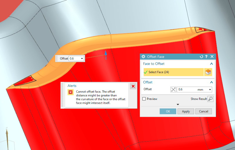

hello everyone, can you help me how to editing the solid body from file stp, I need to adding the thickness 0.6mm
Have you tried the synchronous tools in NX. You may have to delete the fillets and recreate them after you try using offset surface or these types of commands.
Like SDETERS mentioned, I'd try Synchronous 1st.
Optimize face, but use the selection to pick the body Faces, Then offset the single face.
If the geometry is clean it should move and adapt the blend faces.
if not? untrim the flat face you want to move, offset it your distance and re-blend
You can select the surfaces as "single" and use the "offset face" command.
Hello,
if You still have problem try this:
- draw extrude rectangle (or other shape) to red faces (and a little to left and right of red faces).
- replace one of side faces of your cuboid with face to offset.
- offset replaced face at 0.6 mm
- substract cuboid from main body
- add blends.

Thanks guys for the solution,
I've tried using synchronous tools also like SDETERS and Rob_N mentioned, with this method I did it, but I am not sure that the fillet still the same as before, it has forbidden to change the radius, any suggest ?

It will be a bit of a forced method, but I would do it like this: first I copied the surface that was just the radius with "extract surface". I would delete the variable radius with the 'delete surface' - 'blend' option. I would assign a larger variable radius by referencing the copied surface.
You could try Synchronous Modeling "Offset Region" and select all the faces except the blends into the main body.
YOu could always unsew the surfaces, and offset the ones you want, resew, trim and re-fillet.
