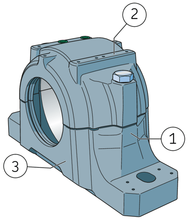

Hello everyone,
I have a conveyor that is supposed to run 24/7, though it is now running nor more that 10 hours per day, and I would like recommendations for monitoring and maintaining two Plummer blocks with roller bearings (I believe shaft size is 70mm). There are grease nipples, so that's something but part of the check list requires taking heat measurements and my question is where would the best area be to measure the temperature. I downloaded a .pdf showing the structure of the block and the bearing appears to be mounted in the middle with seals on both ends of the block. I elected to measure at the seal because the shaft transmits the heat from the gear box which gets quite hot.
SNHF 516 instruction manual
Thank you.
Closest to the bearing is the best place to take the measurement. What are you using? Are you going to install a thermometer in the housing or use a non-contact method? The non-contact method isn't precise so it doesn't matter much where you take the reading, just try to get it in the same spot every time.

I'd expect the main relation between temperature and re-greasing interval is due to higher migration rate of the lubricants from the thickener with increased temperature, so it's really the bulk temperature that matters - whatever temp the housing should be sufficient, but if you are also adding a lot of heat through the shaft, then measure the shaft temperature.
You might also add a static shield to divert radiated heat from the gearbox away from the bearing block.

As far as operating temperature measurement is concerned: the rule of thumb is that based on a assumed standard operating temperature of 70 degrees C the regreasing interval should be halved for every 15 degrees C higher and should be doubled for every 15 degrees C less then 70 degrees C, for a standard lithium grease. When using a better quality grease, the regreasing interval probably could be doubled.
As for temperature measurements I would suggest to measure the temperature of all the bearings for a certain amount of time after say 5 hours of continues running. That will give you an idea about the average operating temperature of the bearing of the grease and might also tell you whether all bearings more or less give the same reading or that they differ depending on location or bearing "health". From that moment on you have a baseline value that can serve as a guide for future maintenance.
