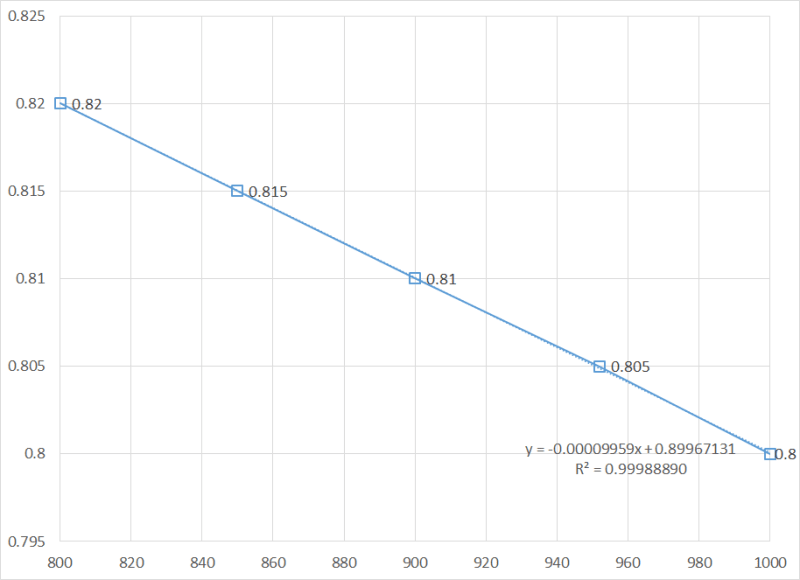

Hello everyone! :)
Is there anybody who could help me please?
I would like to fit a line into 5 fix points. I'm trying to do it with a function, but the problem is, that the x-axis has logarithmic scale.
Maybe I shoud use the loglinear version of the equation of the line, but it doesn't work...
Plase someone help me.
Thanks a lot!!!!

It's a pretty straightforward thing; Excel can do the fitting with its trendline option and displaying its equation, which should take all of about 5 minutes.

I want to do it with Mathcad because I have more thing to do with the task. It's just a little part of it.
Okay, here it is:
In the graph you can see the elements of the matrix A. I put a circle around them. So what I want is to make the green line with a function. The green line must fit into the 5 points of the matrix A. Can you please help me?
I upload the picture I made to explain my problem and I also upload the mathcad file.

Much ado about nothing; the segment is basically a straight line, and would be a perfect straight line, except that you seem to have a typo at the fourth data point, since you have 952 , but f(950)
