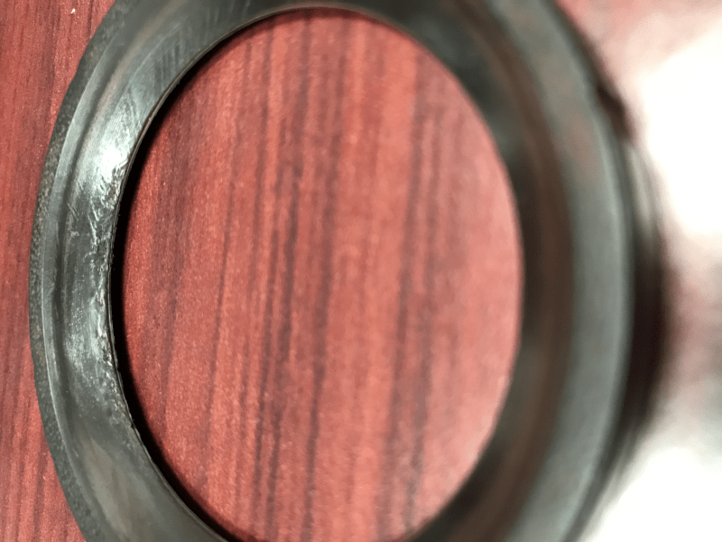

We have actuated ball valves, 2" NPS, in 70-90 psig (~315-335 F) steam service. The valve is a floating ball design, 2-piece, full port. It does not have any slow open/close mechanisms. Below are some pictures of the seats after only 6 months of service. These valves are actuated, on average, probably 50-100 times a week. The seats are graphite-filled PTFE. The damaged seat is on the downstream side of the valve. I'm not sure of the orientation of the damaged part relative to the seat.
The valve manufacturer insists this looks like an overtemp/pressure problem, but at a boiler setpoint of 70 psig I fail to see how these even approach the T/P limits of the material. The highest I've seen the boiler is 90 psig. The seat appears to have some erosion on the inside face in the failed area, but the entire failure - what with the seat looking like it's pushed up towards the ball - almost looks like it was pinched by the ball. Can any of you with a more experienced eye help me out?
I'd bet that you have a pocket of condensate forming upstream of this valve while it's closed. When the valve opens, the first thing that it passes is a jet of hot water that is also busy flashing into steam.
Do you have a drip-leg and steam trap ahead of this valve?
TBP - we do, but it’s very old. This is at the end of the line for the header. I’ll check out the condition of the drip leg/trap next week. What would cause the seat to turn upwards like that?
If there is no damage to the balls itself (no cavitation, hairline scratches, dirt, abrasion damage etc.) the problem is, as TBC says, probably waterhammer/hot water flashing. Check steamtraps and layout/placement for water drainage.
Are you sure this is the downstream seat? It looks very much like an upstream seat that is pushed into the waterway of the ball port as a valve opens and then the deformed portion is cut-off by the ball as it closes on the inner surface. I just don't see how a downstream floating ball seat can be pushed upwards towards incoming flow & pressure when the valve opens.

I can't say that I'm 100% sure. However, the other seat appears in good condition, and the valve was leaking by. Due to this, I assumed that the misshapen seat was the downstream seat, as that is the sealing surface. If the seat that is still in good shape were the downstream seat, the valve should not have been leaking by. Perhaps what I call the "good" seat is actually bad too? A picture of the other seat is below. The area in focus is only portion of the seat that appears even slightly damaged and is showing only very minor pitting/scratching.
If you have even a hairline crack in the sealing or ball surface on a steam valve either steam, condensate or water will eventually pass, might expand at lower pressure, downstream or when caught in room behind sealings inside the valve, and even give cavitation. Difficult to see which sealing is upstream, but in my opinion the damage is caused by leakage over seals.

I'd say the deformed seat is definitely the upstream seat. I have seen the same damage several times before. The deformed section interferes with rotation of the ball. It catches the ball port as it tries to pass by. Valve would struggle to fully open and close.
I would concur with bcd, this is an upstream seat. As the ball moves from the closed to open position, this part of the seat beconmes unsupported by the ball and if pressure gets behind the seat it can push this part of the seat out. The small grooves (notches) that you can see in the circumference of the seat are there to prevent this by relieving (by providing a flow path) the pressure behind the seat, but if they get blocked they will not function adequately.
