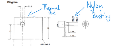

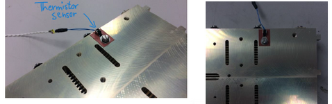

I have a screw preload problem during assembly on one of the products at my workplace.
Basically, production workers have been applying a set torque of 0.82 Nm (which is a typical M3 torque for our products) and realising that this value of torque causes damage to the thermal pad (made from rubber insulated electrical fiberglass) and the nylon bushing.
This isn't a typical preload problem as there a few things being sandwiched between the screw when torqued.
My question is:
How can i determine a lower torque value which will be suitable to ensure good thread engagement and contact between the thermal pad and thermistor sensor but also ensure that the pad doesn't become damaged.
Can someone guide me on how i could determine this?. I know it'll probably involve calculating the compressive stresses due to the axial loading but i'd greatly appreciate if someone could help out with a worked example and the final torque value.
My assumption is that the critical weak point in this arrangement is the nylon bushing which deforms and then damages the insulator pad.
Please see attached schematic to help visualise this as well as drawings for the parts and damage seen during assembly.
Help would be highly appreciated. Thanks.

This is usually solved by adding a spring with a low spring rate and then controlling the amount of spring compression rather than using a very stiff screw and a measurement with a large output range. Even with good control of torque one can get an actual compression range of 50% to 150% of the desired value. In addition you have differential thermal expansion to contend with as the nylon will expand and contract at a rate far greater than the steel screw. Note too that nylon is susceptible to becoming brittle if it is not kept hydrated.
Gaskets often have the same issue with over-compression. You need the correct amount of both pad compression and thread stretch. Increase surface area of the stack on the pad and/or decrease thread size. Its a standard BJA but the tolerance stack analysis becomes more critical with additional parts bc of the added complexity/variability.
you can faf around for a long time trying to calculate a torque, but there are going to be so many assumptions that its doubtful you will get a useful result.
just get some spare parts and run some experiments with various torque levels and sort out a torque range that works.
Change material of the bushing to aluminum or brass. Increase the compressive strength.
Or chose a plastic with better compressive strength.
Glass or carbon fiber reinforcement for the plastic will likely be necessary
It's an electrical insulator, so carbon, brass, aluminum aren't going to help. The shouldered bushing is intended as a compression stop.
I'd go with a sleeve spacer to protect the softer material
Hi Chase123456
In order to calculate the tension that would clamp the parts without damaging them you would need to know all the stiffnesses of the component parts and as already stated you could play around with numbers forever.
What I would do is some trial assemblies starting with tightening the screw finger tight and the turning the screw either a quarter or one eighth of a turn more and see after disassembly whether any damage as occurred and if not that would be my assembly technique, that assuming there are no other external loads you haven’t mentioned. Now if you then wanted to calculate the pre load deflection and or the tensile force this can simply be done knowing the pitch of the thread and the amount the screw as been turned for example if the pitch was 1mm then the deflection would be either 1*1/8 or 1*1/4
