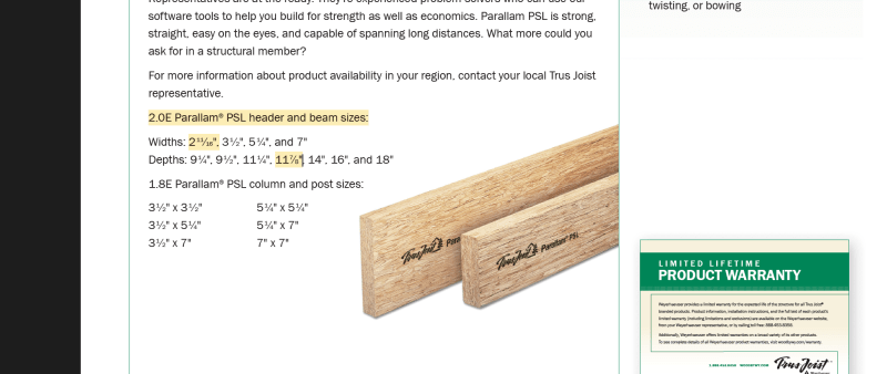

I am doing a remodeling project to add floor in the 2 story living room. Homeowners provide a set of engineering plans. but I am having a hard time figuring out what is exactly for 2 11/18" x 11 7/8 FL. PLB meaning. it is enginnering wood beam? parrallam? TJI? I don't know what is "FL PLB" stand for.
The number in the hexagon is the beam number, which refers to structural calculations, which I don't have.
The number in the diamond is TJI 15, which is a legacy product by Trus Joist which no longer available.
I need to know what it is so I can determine if I can attach floor joist
I'm guessing that "FL" means flush. And "PLB" means Paralam beam.
But the 2 11/16" doesn't make sense. I've never heard of beams with that thickness.

I think you were right. I did find in Wayhauser, but funny thing is I can't find such product in their Fortweb software.

2-11/16" Parallam PSL was available in eastern markets on and off for a number of years. My understanding is that it is not currently available as a product for sale, but this product can also be resawn in thickness to achieve this size. I agree with the comments above that this is likely indicated a 2-11/16" PSL flush.
