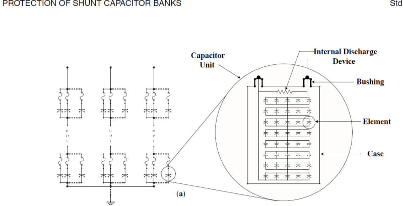

Lastly when IEEE-C37.99 refers to a capacitor unit in the image below:
In regards to the sample bank provided what is the capacitor unit they are referring to?
Would that mean the individual 75 kVar units are connected per phase or is that not a correct interpretation?

Lastly I wanted to ask about a sample image in IEEE-C37.99 which refers to a "capacitor unit" in the image below:
With respect to the 150 kvar sample bank you reviewed earlier what part of the capacitor bank is the "capacitor unit" in the image from the standard refer to?
Based on what they are showing I am not clear if each 75 kVar enclosure represents a "capacitor unit"
If this is the case does that mean the each 75kVar unit is connected per phase since they they show a single "capacitor unit" per phase or is that not a correct interpretation?
Dear Mr. Wfg42438
Q1. " ... a sample image in IEEE-C37.99 which refers to a "capacitor unit" in the image below:
With respect to the 150 kvar sample bank you reviewed earlier what part of the capacitor bank is the "capacitor unit" in the image from the standard refer to? "
A1. The LHS drawing (a) is correct, showing a 3ph bank internally connected in Y formation. Each branch may comprising of numerous " group " [each group may comprising of 3 or more " capacitor unit" connected in parallel]. Each " capacitor unit" is further broken down with greater detail shown in RSH drawing. There may be numerous " group " connected in series.
Q2. "...Based on what they are showing I am not clear if each 75 kVar enclosure represents a "capacitor unit. If this is the case does that mean the each 75kVar unit is connected per phase since they they show a single "capacitor unit". per phase or is that not a correct interpretation? ..."
A2. The RHS drawing is correct, showing detail of a " capacitor unit" . In this drawing, it shows
a " capacitor unit" comprising of 8 " group " , each " group " comprising of 5 [" basic elements"]. Total of 8 [" group "] are connected in series.
Che Kuan Yau (Singapore)

Yes, each 75kVAR box is a capacitor unit, the part inside the circle from the standard drawing.
The capacitor units you have are 3-phase, not single phase as shown in the standard drawing.

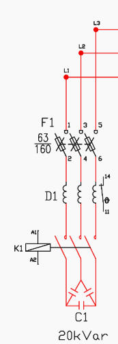

In reality, this bank is connected together to deliver 150 kVar into the three-phase system directly something like the image below.
Where the connection diagram shown below say "20 kVar" (sampled from it would really be two sets of capacitors connected to the three-phase system delivering 75 kVar each

Q5. In reality, this bank is connected together to deliver 150 kVar into the three-phase system directly something like the image below.
A5. Use two 3ph banks each rated 75kva, connect them in parallel. It is also possible by using two 3ph banks [100kva + 50kva] = 150kva , in parallel; or any other combination from the "standard" bank available.

Each 75kVAR box from your pictures is a capacitor unit following the terminology used in IEEE-C37.99.
The 75kVAR box contains a number of capacitor elements to build it.

Q1. If I’m not mistaken the only difference between my example and the IEEE-C37.99 “capacitor unit” is that in there description each capacitor unit is 1phase.
A1. The "capacitor unit " shown in the LHS drawing (a) is a typical [1ph unit] with [two terminals/wires]. It is MOT a 3ph 75kva bank (which is a 3ph stand-alone bank in a metallic enclosure/tank shown. A 3ph bank [shall] be with three terminals, NOT [two].

Q3. Instead each unit would interface the system similar to this image.
A3. If your 3ph system requires 3ph 150kva, order two numbers of each 3ph 75kva and connect them in parallel. Treat these two paralleled banks/tanks as one 150kva bank (even though they are in two separate stand-alone enclosure/tank. Attention: the fuse shall be sized for 150kva rating. When the fuse blows, [two] banks go off. You may use two each 3ph 75kva stand-alone banks, each fused based on 75kva. Advantage, when one fuse blows only one 75kva bank goes off. Attention: in this case, these two banks are NOT connected in [parallel]. BTW You may replace the fuse with MCCB, to avoid single-phasing.

Yes, you could connect the capacitors with a power circuit like that.
Your picture shows what appears to be blown fuse indicators so I would expect there to be individual fuses on each capacitor unit. Generally, you will find 3-phase capacitors configured into a bank with fuses on each capacitor unit.
