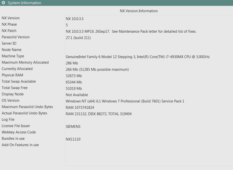

What patch are you running (help -> system information -> NX patch)? Perhaps there is a maintenance release or patch that addresses this issue.

Anyone have an answer? Is this a glitch in the software?
The users in the other thread didn't seem to have a way to consistently reproduce the issue; I'd suggest that you contact GTAC. At the least, they should be able to tell you if it is a known issue.
