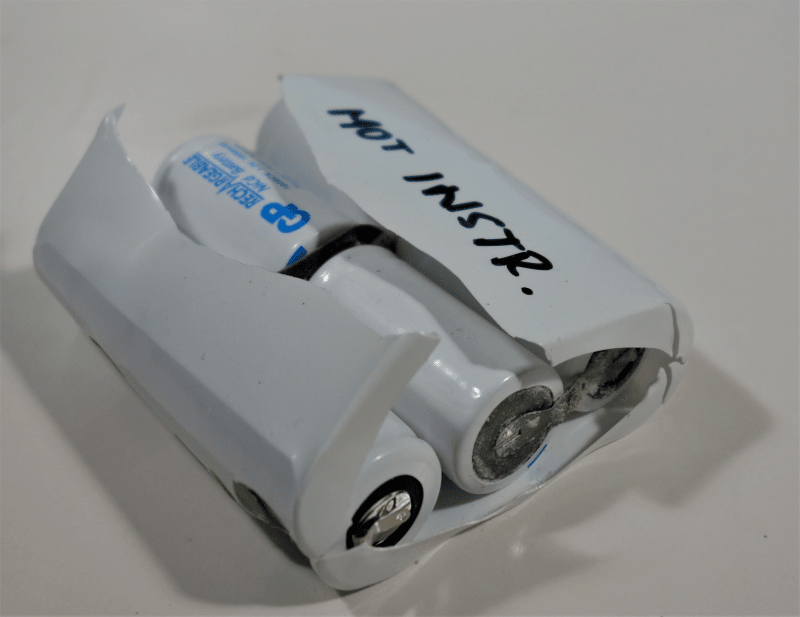

Hmm.. Keth. It IS pulled in the picture.
And, yes. The battery, in the PQA looks like this:
And it is dead. Really, really dead. A stiff. A has-been battery. Longing for the fiords and all that.
Tell me about proper storage of devices with built-in batteries.

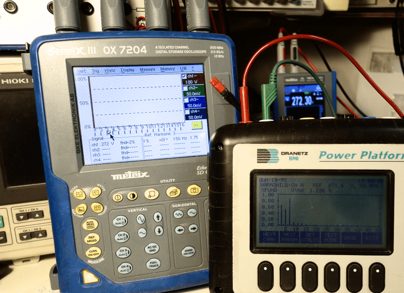

Nice and easy does it!
My trusted wife and assistant said: "You shall have more patience"
After ten tries, I thought that I had shown enough patience. "YOU show some patience!" I said and told her to cycle on/off until something better happened. "What shuold that be?" she asked.
I don't really know - perhaps something different. We'll take it from there"
She sat down and worked on it: ON/OFF/Restart for half an hour. "Is this something different?" she suddenly asked. YESS! The good old flash screen. I tried some basic functions. They were all there. Hooked it up to a DUT and got same readings on my scope as the PQA. It seems to be OK with the UUUUUUUU task card, which it still says that I used last time. This is what I got:
Scopix and Dranetz agree. The 4300 shows more details. Sure. But I don't really need that. So I am happy with the OX 7204. It is a lot more versatile. AND uses an SD card.
I think that I shall try and adjust backlight and date. Next week..
