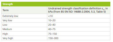

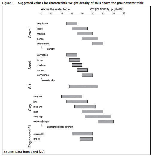

When I have no testing in a Clay layer, other than Cu measured indirectly (i.e. SPT), i use the below. For your 40kPa you would be in the low to medium cat. A unit weight of 18-19 would be ok with me.
Fig 1 is from BS8002 - code of practice for foundations.
PEinc - a high unit weight would be unconservative for bearing capacity and pile end bearing in sand as higher confining pressures.
The values such as that, which are given in the AASHTO code are conservative default values that can be used if data about the on-site soils are not available. I would expect the Eurocode to be similar.
EireChch, I agree with what you said about the heavy unit weight. I was thinking about non-gravity wall design, not bearing capacity for footings or for bearing piles. I should not have assumed that the original post was for a particular application.
