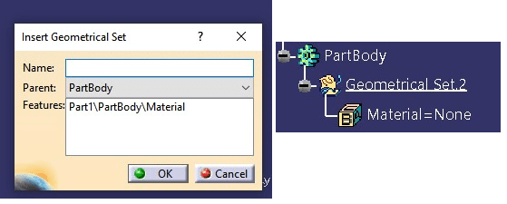

Thanks for the replies.
I can delete the material type but it leaves a material box inside the part body.
Total pain.
LWolf, could you point me in the direction of any script or give me some pointers on how to do it please ?
yeah, there still will be a material box left... but with Material=None
Code:
Dim Selection1
Set Selection1 = CATIA.ActiveDocument.Selection
Selection1.Delete
regards,
LWolf
