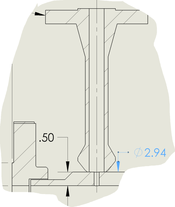

We are welding a 1/2"-300# Sch 40S Branchette to the OD of a 1/2" thick round bar (see attached sketch).

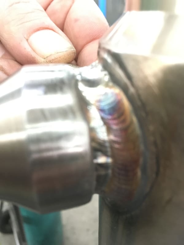

Look at your shield gas (lens, flow, weld speed), that is more oxidation than I like.
I agree with Ed that the weldment is cooling too fast. This is typically an issue in the colder winter months (not sure what your shop temp is).
A little preheat might be in order if things are cold in your shop. But, try completing the weld fully rather than let it cool to ambient between passes. Welders are notorious for hitting weldments with a blast of air to get it to cool quicker when cooling between passes. Remind the welder(s) to mind the interpass temperature between passes.
If you need to slow the cooling rate more, wrap with an insulating blanket after welding. Both of those parts look like relatively large heat sinks compared to the size of the weld.

Why this design?: Fillet welding is excessive as show the picture
Why not use a simple 1/2" sch 40S pipe without an extended section?.
Regards
r6155,
This is what the customer specified.

You also have to be careful when welding this materials with the cleaning devices you are using on the bevel such as brushies and cleanig discs.
