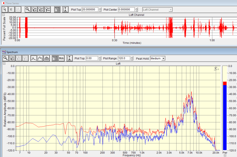

The original description of the sound should probably have stated that noise was intermittent and not continuous. It also was not a pure tone or single frequency at 7000 Hz. Here is the culprit making the noise:
Here is the time wave and spectrum (red is maximum and blue is average):
Everyone feeling bad about not guessing that the noise was from a mouse toy!

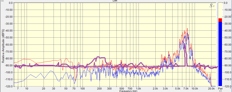

Hi Strong, I viewed your video and that is a similar toy however, when the toy partially depressed in a locked position it emmits a continuous tone. The spectrum plot I was seeing on my phone showed a significant spike upto 50 db and would increase and decrease with distance. The plot I was looking at matched the purple line in the image below. I took the reading a couple different days and it always showed a spike with the peak between 6900 to 7200 on different days.
dang,.. dueling spectra.
