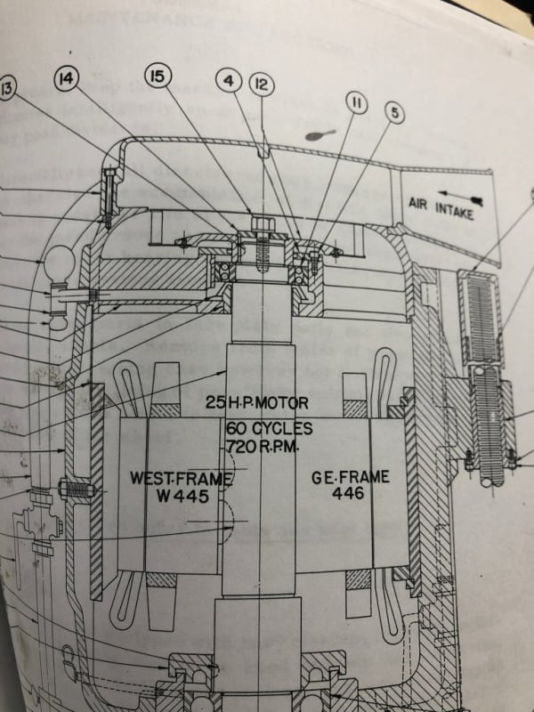

No name plates on these motors.. They're in-house motors made by the machine company. They do state 25hp in several places.
The entire machine is plated "220V 65kVA" But this entails the '25HP' motor and a large geared rotating table the 25hp works against. I think it's 5hp.
The motor is stated as:
WESTFRAME W445
or
GE FRAME 446
It's served by 480V 30A and has an associated step down 220V transformer.

I can't find a 446 Frame motor.
A 445 Frame will be about 100 HP at 900 RPM. (As much as 250 HP at 3500 RPM)
I am guessing that the wrong nameplate may be fitted.

NO nameplate is fitted.
This is in the manual.
Thanks for checking!

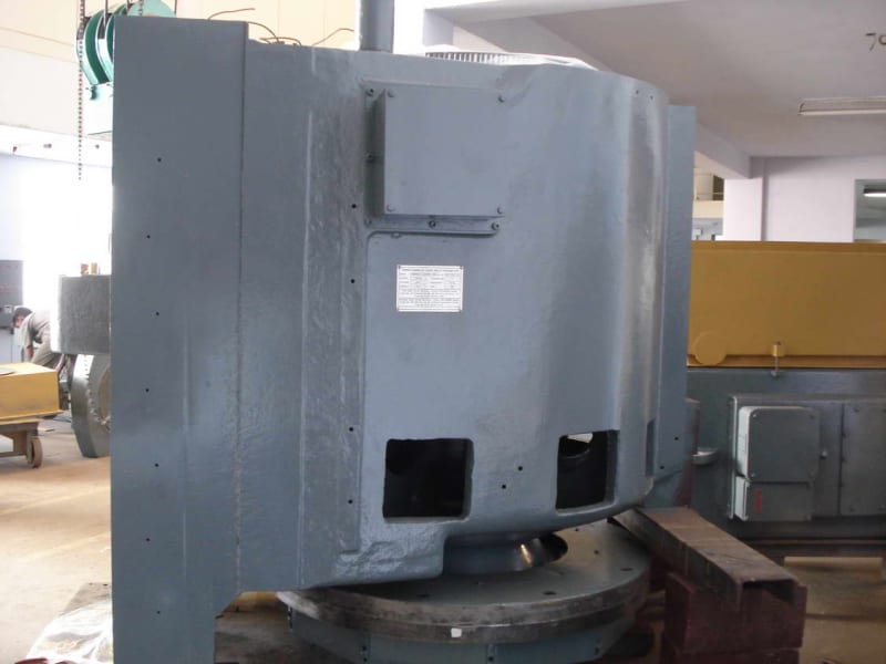

fwiw, the machines we did had stator core of 250 mm long and 900 mm OD and were rated for 415 V, 150 HP, 210 A, 50 Hz, 300 RPM, 20 poles.
Unable to upload the image into the post or as a link.
Muthu
I was wondering about that Bill. I was assuming BIGGER more MASSIVE more stable.. But I bet your example is more on target.
edison; Thank you very much for that info. I was actually thinking "Muthu might have an idea about Blanchard motor currents".
That is a monster compared to this one. 6x the horsepower! Definitely metal grinding.

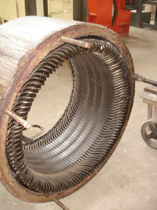

Keith - Yup, machining ceramics is a different ball game. Since my client found the original 300 RPM was too fast, cutting the life of costly diamond tool tips drastically, I did the Dahlander conversion. With some of the ceramics, even 150 RPM was found to be too high. So, the client later on went VFD route, altivar drives, IIRR.
Here is the pic of the motor with original stator winding.
Muthu
jeff
the higher the pole count, the lower the inductance in the motor
In ac motors, for a given frame, the higher the poles, higher is the no. of turns per phase as per EMF equation, which would imply higher inductance, no?
Muthu
