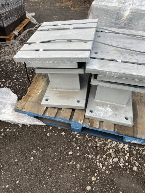

I ended up doing elastomeric bearings with w-bolsters as the majority suggested. Definitely cheaper to fab with all the machining for the old rockers. I'll post some pictures when I go the site.

Unfortunately, that's the only picture I have now showing a side view of the expansion bearings. pedestal is a w section and top is elastomeric bearing with PTFE sliding surface.
