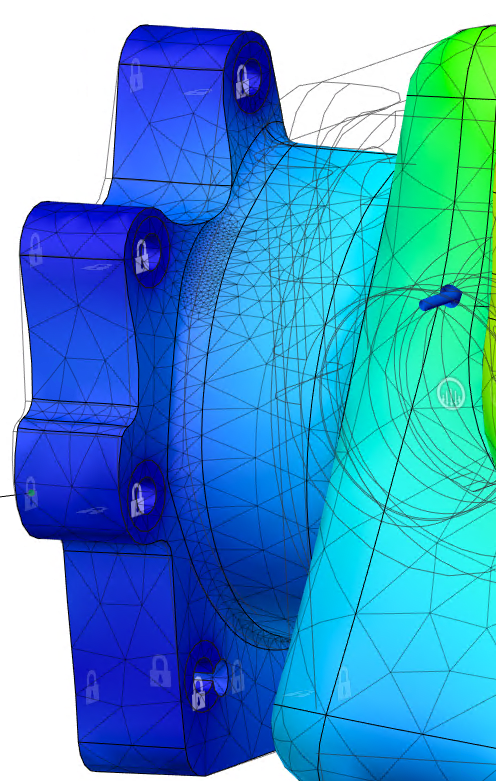

Hi all,

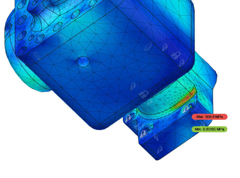

I am posting in hope of someone helping me analyze a high stress that I am seeing on a fillet in my FEA simulation.
For reference I am using Fusion 360 and running a static linear analysis. Everything else in my simulation is perfect except for this one fillet.
I am simulating with Aluminum 7075-T6 with a 455MPA Yield and 525MPA Ultimate.
As a side note, my simulation does converge as seen below, so I know this isn't a singularity / hot spot / calculation error.
The stress on the fillet is pictured below. It is a 5mm fillet. Making the fillet small makes the stress area longer. Removing the fillet makes the stress area disappear.
I am confused about this because I see many mixed opinions on how to handle this:
1. Oh just ignore it, its artificial, stresses like that on fillets don't make sense.
2. You need to fix it and make it disappear or except a failure.
3. Since the effected areas volume is so small you'll see a local yield which wont make the whole part fail, but it will fatigue over time. Compared the max stress to a S-N curve to determine how many cycles you'll be able to get out of it.
4. If you are really worried and don't trust any of the above, run a nonlinear analysis.
My personal analysis is leaning more towards number 1 & 3. Such a high stress on a fillet really doesn't logically make sense (I could totally be wrong), especially when the fillets actually bring out the stress in that area. Removing the fillet, the stress in that area goes away too. Since the effected volume is so small, its just a localized yield and those are OK and don't mean complete part failure instantly, just eventual fatigue failure over time.
Hoping someone can provide some insight on my personal analysis and tell me if I'm thinking correctly or not. I'm fairly new to FEA.
Many Thanks!

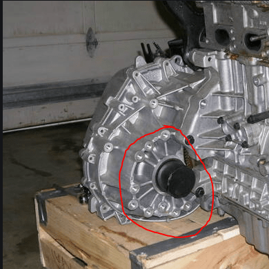

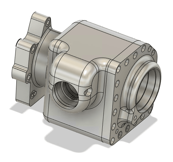

I am simulating a redesigned transfer case for an AWD vehicle. Its contain a ring and pinon gear set. Its a two piece design, but I am simulating that case plate as bonded. I have done the bolt calcs by hand and also have tried sims constraining the plate to the case to make sure it doesn't negatively effect the case and it doesn't.
The case itself bolts to a transmission that looks like such :

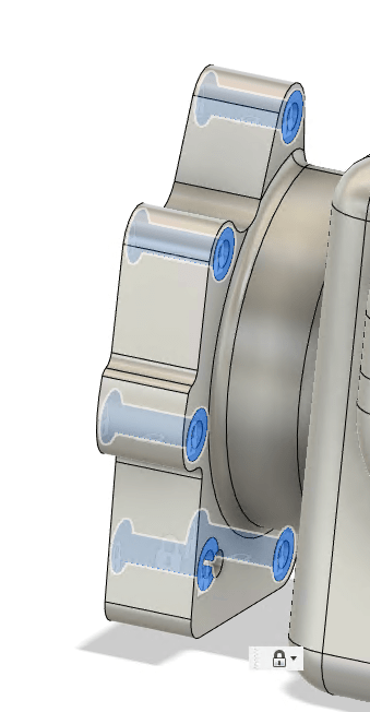

I have my constraints setup as follows... basically the 5 bolt holes are constrained as well as a split face that the bolt head touches and a split faces that touches those offset bolt bosses on the transmission. I dont have the entire back of the flange constrained because only small faces make contact with the transmission.

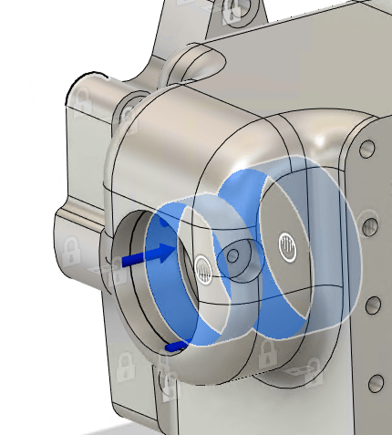

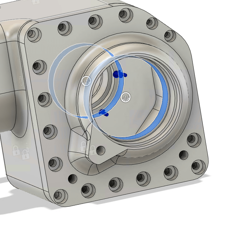

The case has 4 combined radial bearing loads (represented as bearing loads) and 2 axial loads (represented as regular force loads).
Here are the pinon loads:
Here are the ring gear loads:

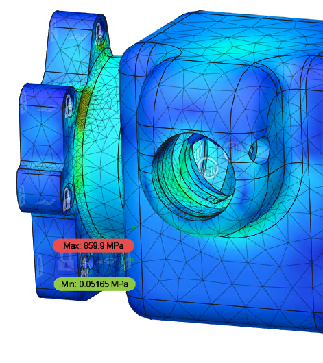

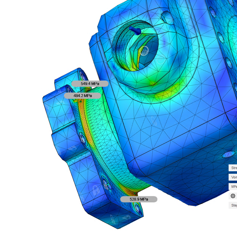

Here you can see we have high stress in two areas on the same fillet. One near the bottom and one near the top:
Bottom:
Top:

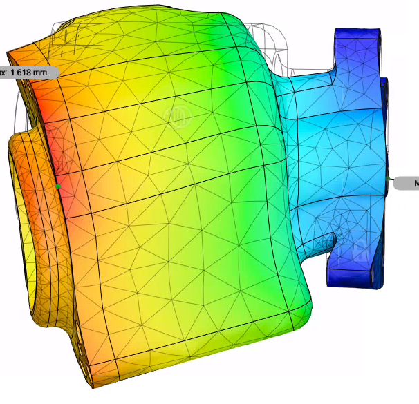

Looking at an extremely amplified view of displacement you can see the structure buckling near that bottom one, which is maybe causing that high stress area on the fillet?
The top is basically seeing the opposite and getting pulled apart (kinda hard to see without stepping through the scales).
What i just really dont understand is why the stresses in that area go away when the fillet is removed. I would think a finely meshed fillet would help alleviate them.
Hard to tell but the stresses are also really only on the surface. They dont extend deep into the piece.

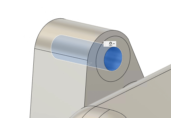

is this an FEA package inside a CAD s/ware ? I'm looking at your constraints and it looks to me like you're constraining the surface (something I see in CAD FEA). I think you need to be careful with this type of constraint, it is easy to over-constrain the model which will create problems in the FEM results. Now I doubt this is causing your stress peak. I think you've a mild stress concentration, exaggerated by the linear FEA. If this is a fatigue load case and you're seeing plasticity then that's probably a bad sign. I suspect the only practical solution is to increase the fillet rad. There are other treatments but not really suitable for mass production. Possbily a material change ?

Correct this is a FEA package inside of my CAD environment. Autodesk Fusion 360 has an integrated simulation environment. Let me better show how I have my constraints setup. Basically I am constraining the bolt holes as well as the area the bolt head touches and the area the flange touches on the transmission bosses.

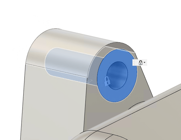

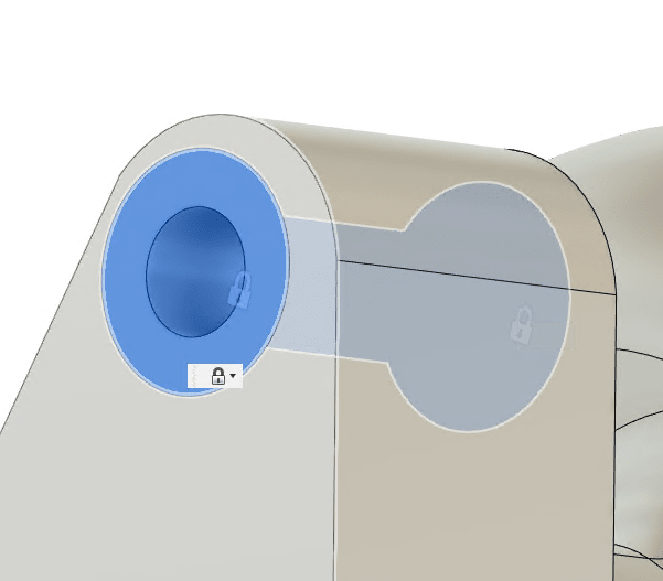

Are you saying that constraining just those surfaces could cause issues? Attached are 3 images of the areas I am constraining.
1.Hole
2.Bolt Head Face
3.Tranmission boss face
Maybe it will be worth my time to run a non-linear analysis as well. I do have access to that in my simulation package.
I assume if I see the same stress concentration occurring in a nonlinear analysis then its not a mild stress concentration being exaggerated by linear analysis and is a very big problem.

yes, that's what I thought. I suspect that locking surfaces in this way is overconstraining the model and not, IMHO, good practice.
But I also doubt that it is affecting significantly your stress peak.

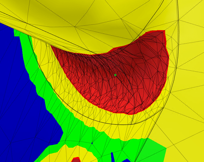

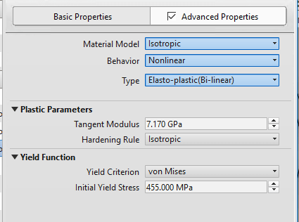

OK... So I ran a non-linear analysis and the results are pretty interesting.
I still have stresses in the same spot, but the magnitude is quite smaller. I am now seeing around the 480-530 MPA range (which is barely above yield), where before they were 860 MPA... [surprise]
Here is how I setup my material:
And here are the results...
I think its safe to say now that the stress concentrations were definitely being exaggerated by the linear analysis. From my understanding non-linear takes into account not only non-linear area of the stress strain curve of the material but also the change in stiffness in the high stress areas.

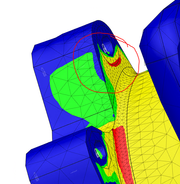

Here you can also see my constraints causing some issues. This IMO is totally safe to ignore. Thats clearly being caused by the split face that is constrained (to represent the bolt head).
Any suggestions on how to better constrain this? Presumably without modeling bolting this piece to a plate (transmission).
If you are applying extreme loads then mild stress concentration is acceptable, because fatigue loads are much lower.
From your NL run you're predicting a peak stress of 550MPa (quite a bit above the yield of 450 MPa). What's the endurance limit of your material ?
from your linear run the peak stress was 850 MPa, so you need to say fatigue loads are 50% of the extreme load before you don't get yielding under fatigue loads (which you want to avoid). At the endurance limit (ok, there isn't one for Al) is much lower than that.
Your later post is a stress concentration at a spot face. This is also near one of your constraints. Which is causing it ? both are ??
