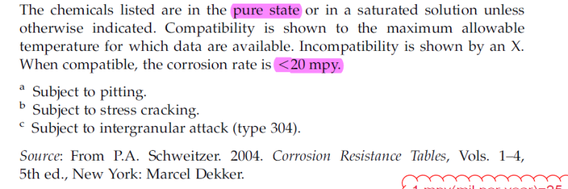

hi, all,
this is a question related to corrosion of SS under high temperature ammonia gas.
It's the AIG(Ammonia Injection Grid)in the Boiler system, which funcitons to control the NOx in flue gas by injecting gaseous ammonia of a high temperature around 400C.
the Ammonia distributing pipe are fabricated with 304, while i find the follow table in a corrosion handbook:
it implies that 304 is not compatible to the temperature higher than 90F(32C), under which condition the corrosion rate is larger than 20 mpy, while in other sources, like NICKLE INSTITUTE states that "the stainless steels are used safely for high-temperature service in hot ammonia atmospheres". i believe both the sources, ther must be something wrong with my understanding, could you please shed some light on it? also, what is the corrosion mechanism of Ammonia in high temperature?
Thanks so much.
Your table appplies to a gas mixture without specifying the Molar content of the combined gases.
Yuo need a more reliable source.
thanks for response, hacksaw.
respectfully disagree.
below is the note to above table. it is pure chemical.

thanks hacksaw,
i am not quite concerned about the composition of the flue gas.
i currently just want to figure out why the corrosion handbook, which seems quite trustworthy, show data conflicting with NICKLE INSTITUE's statement, which largely undermine my trust to the entire book.
thanks
You hand bookseems to apply the NH4 refrigeration, not process plants that have much harsher environments especially when treating flue gases, of unidentified composition.
hacksaw, i don't think so. it's a handbook for general use.
General use, for the temperature range of NH4 cooling lines.
Your stated application is "AIG(Ammonia Injection Grid)in the Boiler system, which funcitons to control the NOx in flue gas by injecting gaseous ammonia of a high temperature around 400C" which is much harsher.
How hot is your Amm injection piping system?
Is the Amm actually pre-heated to 400C?
Or is it entering this line as liquid and then boiling before injection?
Your table does puzzle me.
My Compass guide shows pure dry Amm to 500F and wet to 600F with little to no corrosion, <0.05mm/yr.
This then gets more severe with increasing temperature and within another 100-150F they are both not recommended.
The worst thing for SS would be having any Cl contamination.
The exclusion of all oxygen lowers corrosion rates by 100x or more.

the handbook name is "Fundamentals of Metallic Corrosion: atmospheric and media corrosion of metals" authored by Philip A. Schweitzer.
