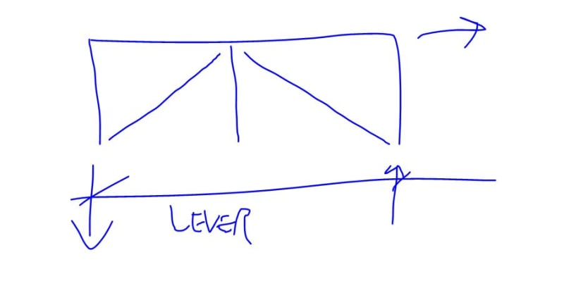

Hello. I am currently designing a platform for a client who does not want any footing. The column is connected to a base plate and grouted around the plate. I have been getting an uplift of around 24 Kips, while designing with Risa 3D, which does not seem logical. I went with dynamic analysis for seismic, which is giving me such high uplift. I also tried with ELF method and although the uplift is lower, it is still around 16 kips. Is there a way to reduce the uplift to around 9-10 kips?
If it's spatially acceptable, You might use two adjacent braced frames to increase the lever arm of the entire braced frame assembly.
If this would get you to a load that you'd be willing to resist with the SOG, it may well be cheaper than foundation work.
