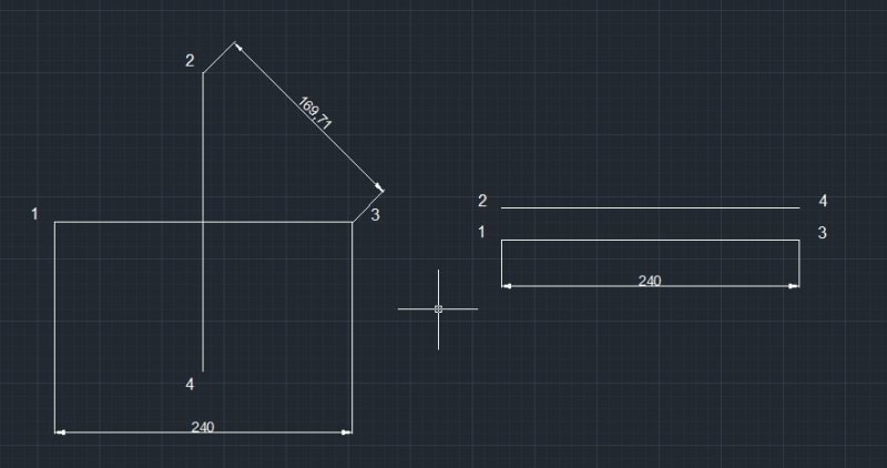

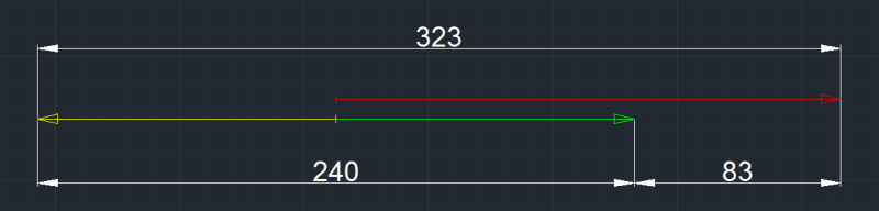

For the voltages measured in the secondary, it looks like the voltages are in phase (or opposite phase), like this:
If secondary voltages are in phase, primary voltages must be also, so chances are that the transformer is fed with a duplicated single phase instead of a proper 2-phase, 90º degrees apart.
Check the primary voltages, between the two phases the voltage should be √2 x 120 V = 169.7 V
Hope it helps.

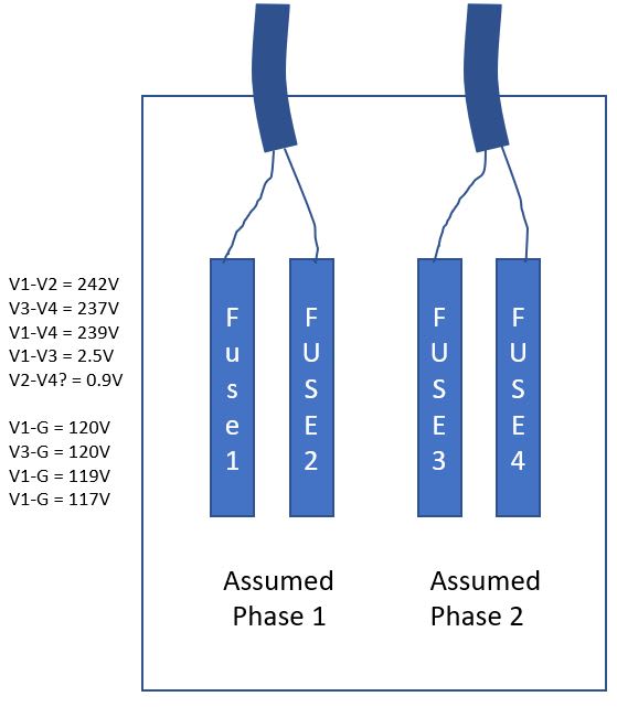

FacEngPE - The input voltage were 242,239,237 as expected.
Argotier - Thanks for the diagram. That totally makes sense. Here's a sketch of some of the other values.
Yes, as suspected you are dealing with two single phases (wich are not identical in magnitude but still in phase), instead of two phases 90º degree apart.
Something like this, but the values measured are somewhat off (measurement + rounding errors probably). I will now use your phase designation (diagrams above used the trx manufacturer designations):
Now you only have to find where the phases got mixed up, in the customer's circuit or directly from PECO supply.
