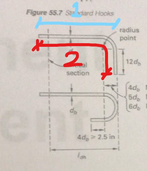

i want to know, if the development length of the hock is includes the tail of 90 degree, or only the straight part of the development length. according to the attached photo is it option 1 or 2.
It's #1 per the Ldh dimension at the bottom of the sketch that you posted
