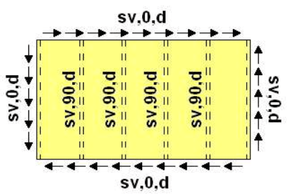

What we basically do, is we connect end studs with bolts/screws and design them for shear flow sv,0,d.
sv,0,d is design shear flow between sheathing and timber frame on the perimeter of wall segment.
You can calculate it as sv,0,d = Fh,d / L, where L is length of the wall and Fh,d is design horizontal force.
