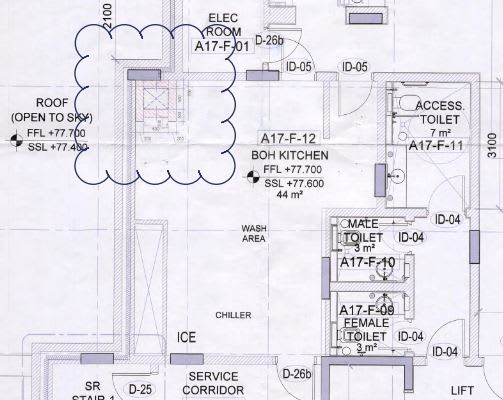

what are the requirements on making a hole in a existing slab, is there any restricted area for example near the column?. and what are the things need to be check??

thanks for all the response. its a 600x500 hole for the kitchen exhaust duct.
Jandra11,
You have asked a structural question, but have shown us a part architectural plan. That doesn't help. If we could see the structural drawings, we might be able to give some useful advice.

@hookie sorry i just use this one to show the size of the hole and its location btw this the structural drawing that i have. Link
there will be a perimeter beam, does it mean punching is not critical on this scenario?
