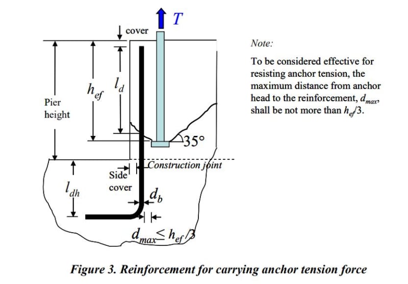

1) There is no code requirement to hook the bars at the top that I know of.
2) Whether or not hooking the bars is necessary for anchorage depends on the anchorage design approach that you choose to use. There are several possible methods including ACI anchorage, AISC Design Guide on Base Plates and Anchor Bolts, and Widianto (below).
3) Where possible, I prefer to get the anchorage done without the use of hooks. I feel that they add congesting in a situation where it is unwelcome.
4) Your ties at 4" oc are also a function of your anchorage design and design methodology. If you need 'em you need 'em. It's not a bad practice at all.
Providing adequate development of the reinforcement in relationship to the loads you are transferring could lead to hooks at top or bottom.
If you have are utilizing skin friction for tension resistance and have narrowed your capacity down to the last feet or so, I would recommend that you have enough developed reinforcement at the bottom sections to transfer those loads.
Yes, the details appear correct. The hooks at the bottom though are not needed for engineering reasons but may prove useful for tying their spacer blocks off on when they are setting their rebar cage. You definitely want the hooks at the top. Since the steel structure has force continuity into the foundation you will need to develop your vertical reinforcing steel in a short distance (i.e. from top of shaft to bottom of anchor bolts) and the hooks reduce this distance. The tighter spiral/tie spacing at the top is because some codes allow you to take a further reduction on your rebar development lengths if you surround them with closed ties at no greater than 4" spacing. I know AASHTO does. Not sure about ACI or Eurocode. The tighter spiral/tie spacing at the top will also theoretically increase the anchor bolt breakout, however, I don't think ACI recognizes it per that configuration.

AValdes, you asked for any reason, and that's what you got. Should you hook them? No.
See Figures R17.4.2.9 & R17.5.2.9 for reinforcing for anchor tearout. The detail above doesn't qualify.
