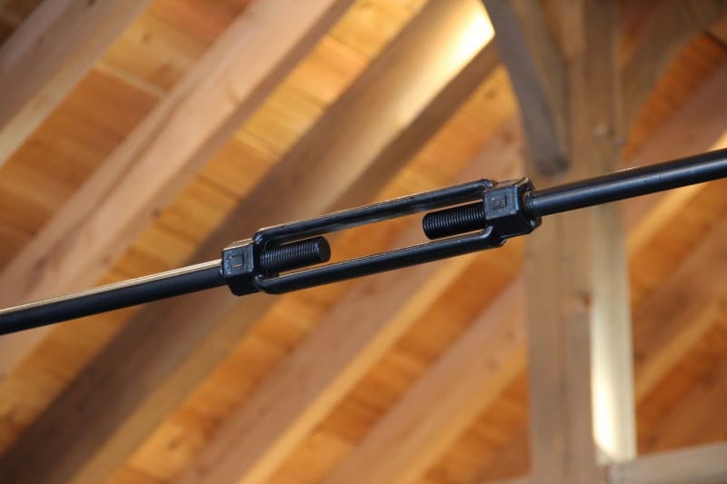

Also
use cross tie rods/bars (pretension using turnbuckle) this will reduce your CHS to 60-80%
this will increase your truss stiffness [in both direction against lateral loadings]

This is helpful. I can likely reduce the snow load with the assumption that it will remain heated since it is a greenhouse. That does not help with wind loads which are resulting in the base members to be overstressed. Tie rods don't help much in that case either. Perhaps the flexibility of the frames allow the load to redistribute substantially under wind loads.
Tie rods works like pre-Stressed structure, counter the expected wind lateral forces, So they do matter
the total structure weight reduced just by adding them (have done this procedure multiple times with STAAD Software)
