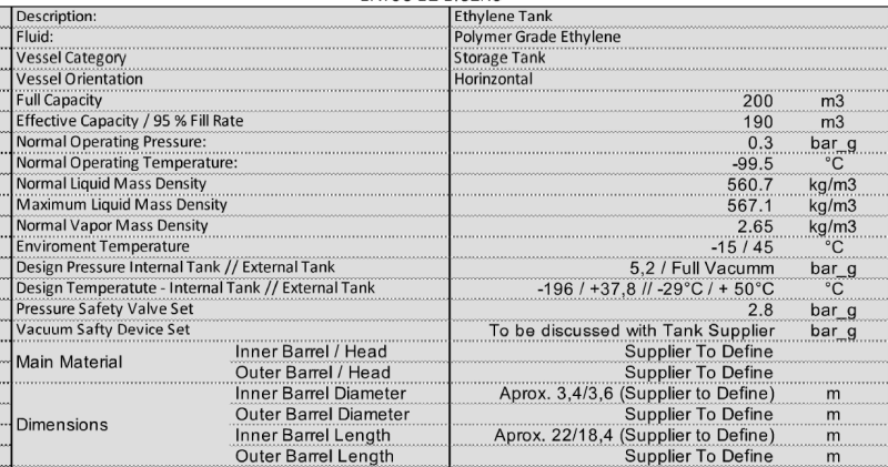

Good morning, I am starting the design of a double-walled horizontal pressure vessel to store ethylene. For temperature reasons, to avoid boiling of the ethylene, a double-walled container is proposed, with a vacuum in the annular space to act as an insulator. The design code needs to be ASME 8. Studying the code has raised doubts about the design process to follow. I understand that the internal container is designed by internal pressure, and the external container by external pressure, contemplating in the latter case a design pressure a little higher than atmospheric.
I appreciate any opinion on this, thank you!

You are describing an industry standard cryogenic liquid storage tank design. The inner tank is a stainless steel Section VIII Div 1 pressure vessel. For the outer vessel I believe CGA 341 is the design code of interest. The outer shell is carbon steel and is designed for full internal vacuum.
Evacuated perlite is common for insulating the annular space, some vendors have also started to use what is essentially thin metallized mylar sheets wrapped in layers around the inner vessel to prevent radiation between the inner and outer shells.
No need to reinvent the wheel, these tanks are available commercially from various manufacturers. Sizes get up to about maybe 60,000-80,000 gallons (225-300 m3 for you fancy European types) before they start getting too be difficult to transport.

This is so called vacuum insulated ethylene storage tank. I did purchase it more than 10 years ago for LNG project. The inner SS and outer CS vessels were designed per Div. 1. Nothing special. Vendor may offer cold-stretch for inner SS shell per Div. 1 App 44 but it is not mandatory. The annular space is packed with Perlite.
I visited the shop. What they told me was they vacuumed the annular space and vibrated the vessel, and poured in perlite to achieve certain density. It took days to complete the task. They did calculate the volume and knew exactly how much to put in. So stay with what vendor can provide as this is their expertise. Experience counts so using new material may not be good unless it is proven.
Two vendors we have used: Chart Inc in US and Cryeng in Australia.

Regarding the posts, it has a capacity of 200 cubic meters (m3), 52834.4 gallons.
It has an estimated distance of 30 meters (98 feet) and a diameter of 3.6 meters (11.8 feet).
This must also be analyzed, how many mount type supports do you recommend? If there were 2, I can carry out the verification according to the Zick method. But I must also inform myself in case more supports are needed.

here, the design parameters.
30 connections are connected to it, so it must be on supports
In addition, a cold ethylene spray system is planned to maintain the temperature... it is a nice job to study

The inner vessel is designed per code. The outer Jacket is structural, and is not with in the U-Stamp scope of ASME VIII Div 1, but using the Div 1 rules for its design is reasonable.
With all the thermal expansion, design of the piping and supports can be tricky.
Much simpler and low risk just to use insulation.
Also why is design temp so low? That's lower than LNG?

A lot of LNG equipment is purchased like this, rated down to -320F so that initial cooldown can be performed with LN2 before introducing the flammable product.
I can see it for LNG, but 100C below operating temperature is quite a lot.
