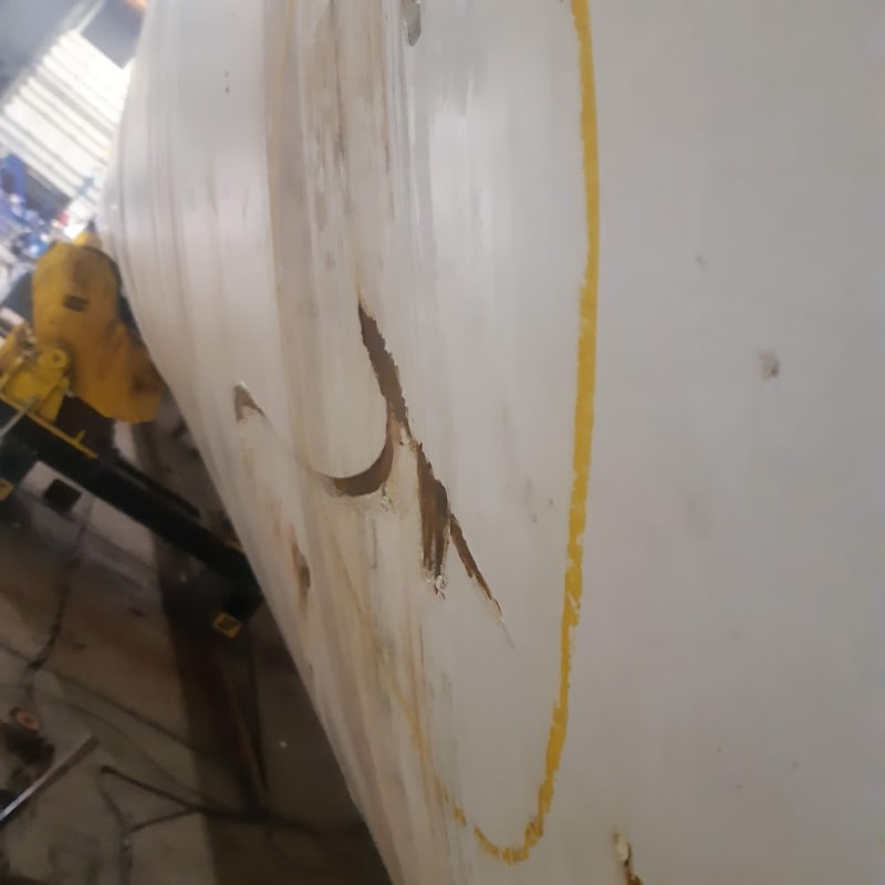

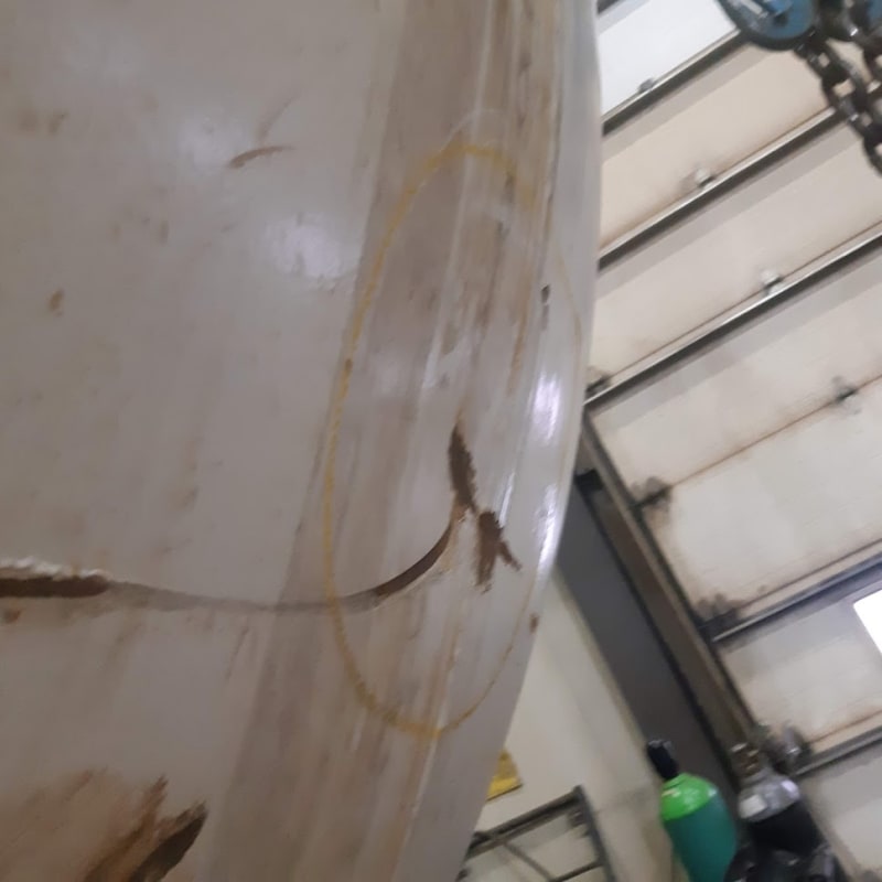

These are the only pictures I currently have. Dent is about .625 deep and 12" in diameter. The dent is unacceptable to the client. For this particular client using the acceptance criteria of the NBIC isn't an option. The tank must look like new.
Sorry, but I agree with your client.
Option 1) cut and install a manhole.
Option 2) Replace entire shell section.
Regards
If you inspect the surface and find no cracks then I don't see any issues with respect to static structural integrity.
If the vessel experiences cyclic service then fatigue may be an issue. PD 5500 Appendix C contains stress calc for peaking which may be helpful.
Hydrotesting the vessel to remove any residual stresses in the dent would be wise.
Issues with superficial appearance is a completely separate consideration.

r6155,
Ask questions if you need more information.
These are the photo I have on hand. I don't have the vessel sitting beside my desk.
Yes, we have a serious problem that needs to be fixed.
The transport had a mechanical failure. The tractor trailer rolled over in the ditch.
We have a good relationship with our client, who understands that this is nobody's ones fault.
Comments stating we have no experience are not useful. You know nothing about what kind of manufacturing experience we have. Accidents happen everywhere.
The goal of this forum is to share experiences (s**t happens) and to try help each other out. If you have a reason from a Code, engineering, or metallurgy standpoint that this shouldn't be done please elaborate. If you want to insult the inner workings of my quality system please refrain from commenting.
Why didn't you mention this accident in the original post ?. I do not have the crystal ball, I am not a fortune teller.
It is unethical to send us incorrect information.
I wasted my time to help you !!
Good Luck
The vessel has a post fabrication dent. How it got there is not relevant to the discussion.

I'd say your proposed repair procedures are pretty close, but per DriveMeNuts I'd add NDE such as MT/PT, perhaps before and after re-forming.
I'd also assume in most cases client approval would be needed before proceeding
I don't think UCS-79(b) is applicable, I'd not worry about it.
I'd guess with enough work you can get the dent out well enough to meet UG-80 rules, but the effects will not become invisible without Bondo :)
